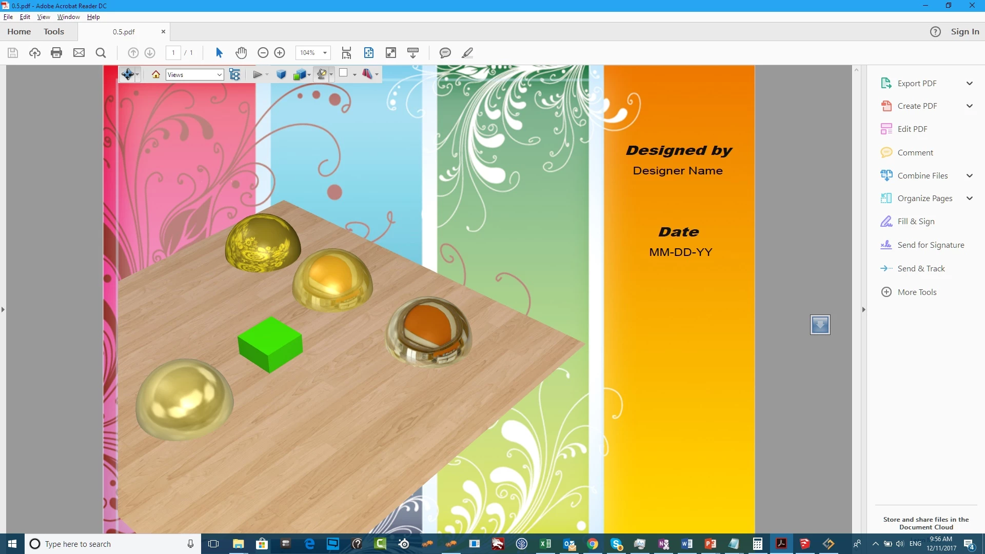

We have a 3D PDF file generated and which uses reflection maps.
It works great on different machines.

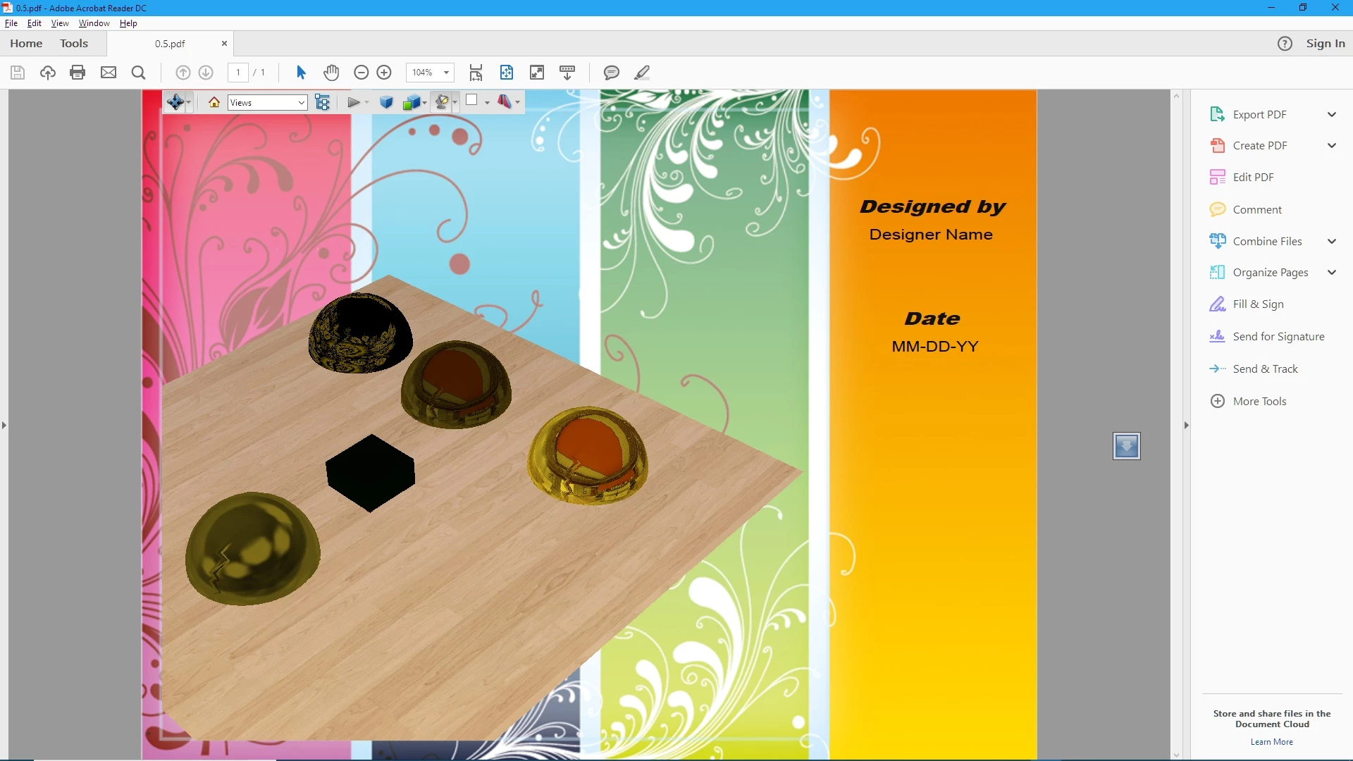

When testing it on an updated windows 10 with nvidia 1080 the geometry appears black.
We are using the latest version of Acrobat reader 2018.009.20050
We did some investigation and we believe that is it using Software rendering, or reverts back to software instead of using DirectX on there new video cards.
Following is the good image with DirectX rendering
Bad image on the machine with Nvidia 1080

    I have found that this is an issue with a setting in Acrobat Preference -> Security (Enhanced) -> Enable Protected Mode at Startup.
    When this option is checked (which it is by default) then Acrobat does not seem to trust certain graphics cards, in my case its also a 1080 on Windows 10, but other users have different setups. So what Acrobat does is simply disable Hardware Rendering, so as you have noted it reverts back to software rendering which does not support Environment maps.
    To me this is a disaster situation since you simply can not recommend end users to update their drivers, or disable a security setting, just to view a 3D model in a PDF document. Adobe needs to address this security settings issue.
