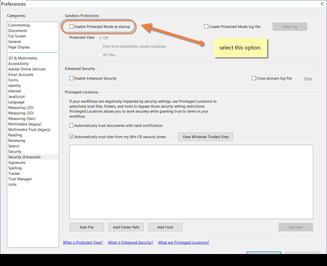

Sep 14, 2018 11:54 AM UTC
I've had this phenomenon too, using Adobe Reader 2018. The cause of the problem was the setting "Enable Protected Mode at startup" in the Security (Enhanced) category. It happens if you deselect this option.
So, no need to reinstall Adobe Reader; just select the option and all is well again. I still have the same problem with Adobe Acrobat and I can't see this setting there.
