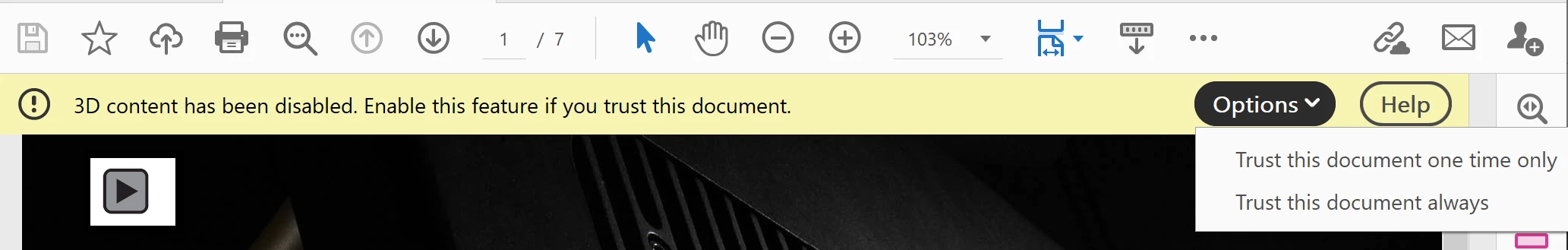

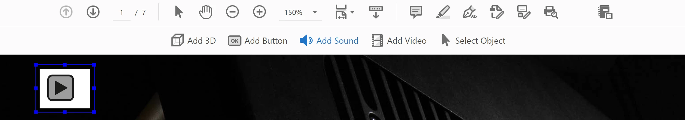

radzmar
October 19, 2020
I don't have see a problem with playing embedded MP3 with Reader 2020.012.20048.
But you'll have to trust the document to start the playback. Select an option from the yellow bar once you've clicked the image of the audio file.
To delete audio file just open the file in Acrobat and then the Rich Media menu you already used to add those files. It that mode you can easily select already existing annotations and delete them by pressing [Del].
