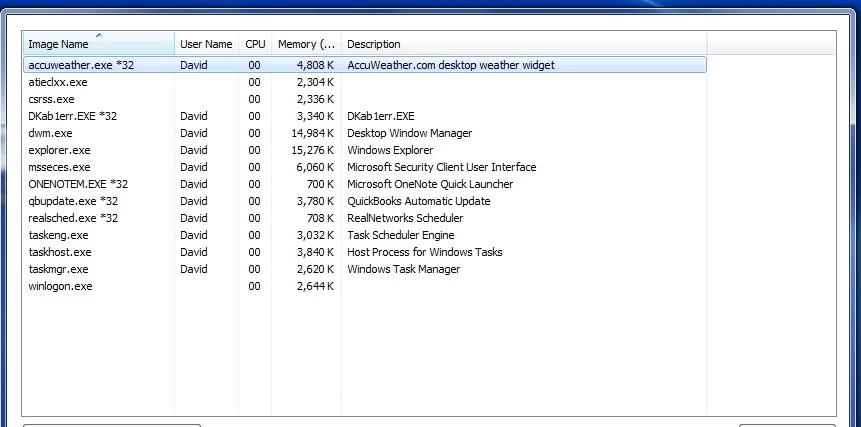

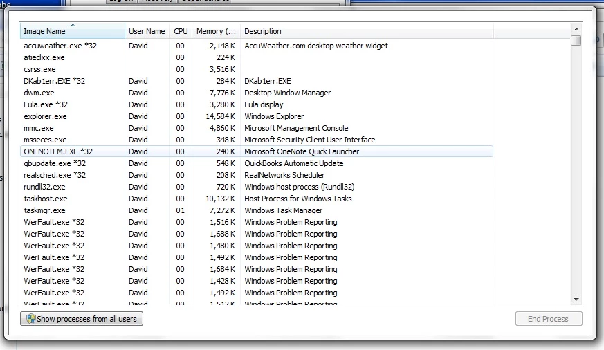

    I have a similar problem it began today 23 Nov 2015. Was running Adobe Reader 10.1.7
    Opening a PDF file produces a Werfault.exe application error pop up to appear, with the message "Instruction at 0x746f7465 referred memory at 0x746f7465. Memory could not be written. Clicking OK or cancel just produces another window with the same message.
    Computer almost ground to a halt, checking Task Manager there were hundreds if not thousands of WerFault operating!
    I deleted Adobe Reader 10.1.7 and downloaded the latest version (10 ?) for Windows 7 (UK), the same problem when attempting to run Adobe Reader. ALL other programs seem to be operating OK.
    Here's Task Manager before...
    Here's Task Manager after trying to read an adobe PDF File.
    Note all the WerFault.exe running and the very small scrolling blob top right!
