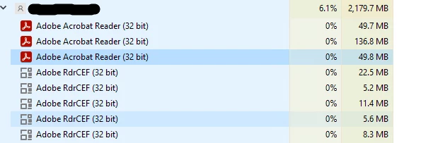

    I have just closed down 24 instances of AcroRdr32.exe for one user, because they kept trying and trying to open a PDF document.
    There is clearly an issue somewhere, is there anything else I can do to gather evidence?

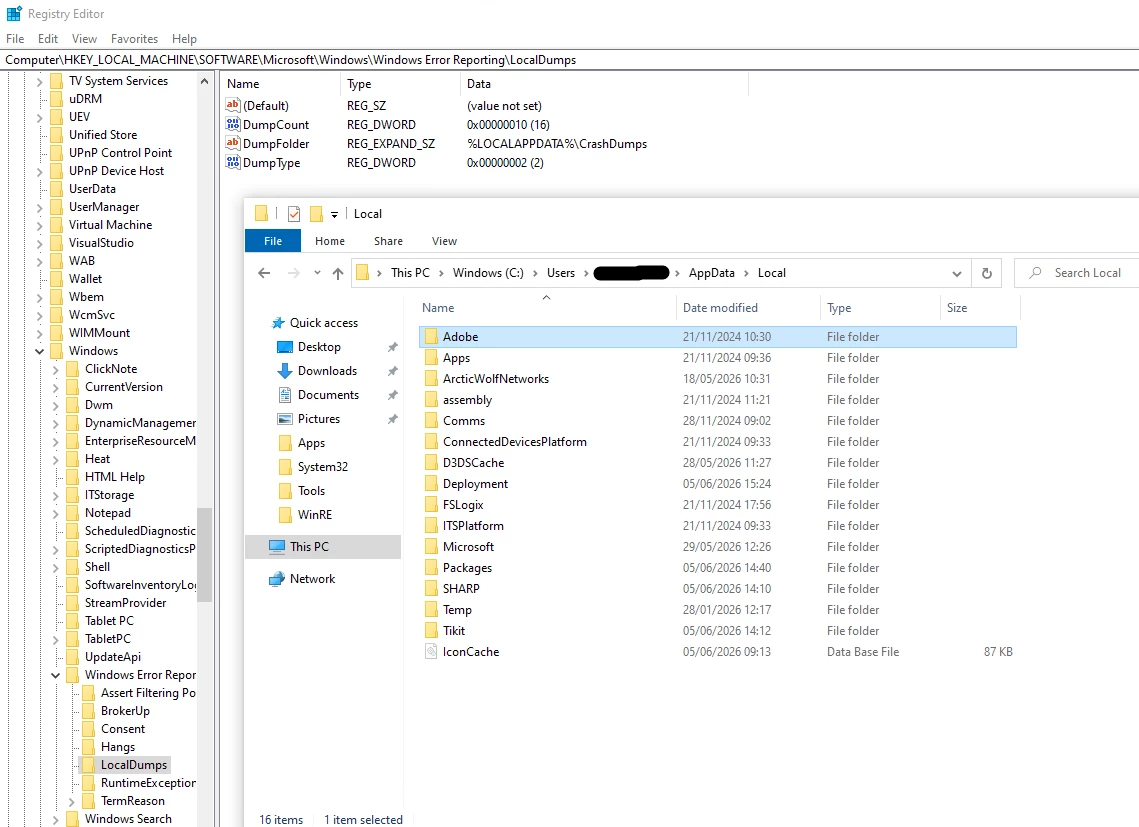

    I have enabled the required registry entries on each of our RDS hosts.
    A user reported an Adobe issue this afternoon, but apparently has had a problem for most of the day.
    For the three AcRd32.exe processes that were available for this user. From being logged in with my admin account I have created a DMP file for each and zipped them up here AcroRdr32.zip
    There is no crash dumps folder in the %LOCALAPPDATA% folder of the user profile.
    The registry settings appear to be correct. But no crash dump files have been created.

    I checked the users LOCALAPPDATA folder, but again there was no Crash Dumps folder present.
    If there is another way I can enable any crash logs?

    We utilise PDFs heavily in our Practice Management system. Users open and close PDFs many, many times per day. This issue occurs randomly across different hosts and users.
    They will try to open a new document and the error occurs.
    We can see multiple instances of Acrord32.exe & the user will have multiple errors.
