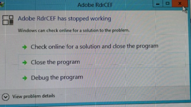

Adobe RdrCEF has stopped working
Server 2012 R2 RDS server running adobe reader DC 2021.011.20039
As of this update users are randomly getting an error message. see attached.
I have done a repair install. Uninstall/Reinstall, disable cloud drive preference, renamed RdrCEF.exe to RdrCEF_OLD.exe adn RdrCEFServicesUpdater.exe to _Old.exe as well.  Still occurring.  I found a thread from 2017 where this same error was occuring.  Tried the above solutions and nada.  Will try downloading an older verison in the mean time.  But any ideas?

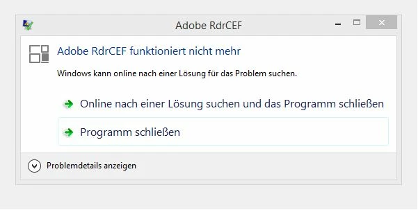

Feb 16, 2022 9:16 AM UTC
Sorry, I have no solution, but the same problem.
Server 2012 R2 RDS current Adobe Reader DC Version.
Adobe puts out the attached error. You can confirm it and continue.
We tried a repair, deinstallation and new installation. Error message occurs again.
We have the message a plugin error in a third party software or native open a pdf with adobe reader dc and while we close the app, the error occurs. Any ideas? Thx in advance.
