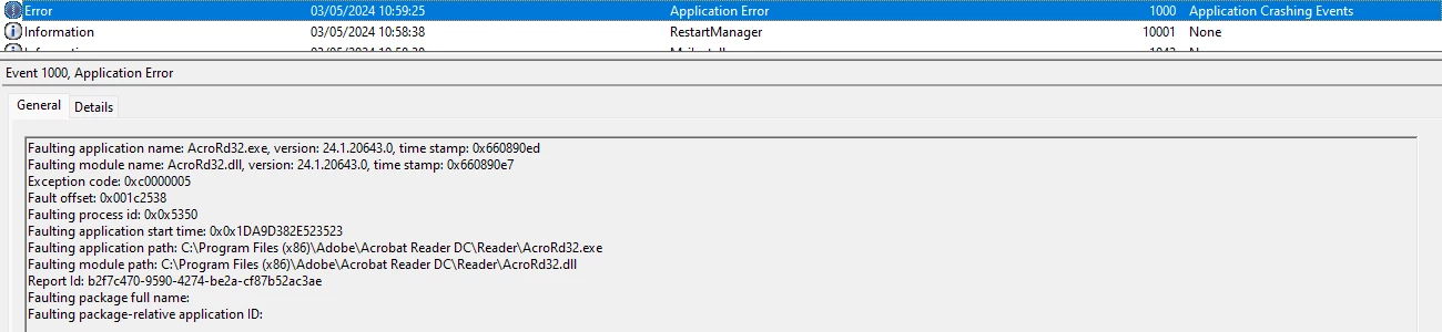

In the evenviewer we get a 0xc0000005 exception:
Faulting application name: AcroRd32.exe, version: 24.1.20643.0, time stamp: 0x660890ed
Faulting module name: AcroRd32.dll, version: 24.1.20643.0, time stamp: 0x660890e7
Exception code: 0xc0000005
Fault offset: 0x001c2538
Faulting process id: 0x0x5350
Faulting application start time: 0x0x1DA9D382E523523
Faulting application path: C:\Program Files (x86)\Adobe\Acrobat Reader DC\Reader\AcroRd32.exe
Faulting module path: C:\Program Files (x86)\Adobe\Acrobat Reader DC\Reader\AcroRd32.dll
Report Id: b2f7c470-9590-4274-be2a-cf87b52ac3ae
Faulting package full name:
Faulting package-relative application ID:
We discoverd the issue appears on devices with Macroview DMS installed.  Is this a know error?  Does a fix exist for this error?

What is your OS and version? Does this only occur with computers where Marcroview DMS is installed? What happens when you uninstall Marcoview DMS?
May 5, 2024 7:34 AM UTC
Hi Adambo,
OS is Windows 11 23H2 (22631.3447).
Installation of Macroview is the latest version 9.9.26.  When Macroview DMS is uninstalled, Adobe Reader is working again.
Today I got the a message in the security center that is was forbidden for adobe to create a child process that points to macroview.  tests have showed that renaming the macroview plugins extension in the adobe installation directory, causes adobe to run again.
