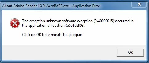

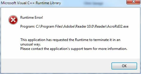

Adobe Reader X - Runtime error - Windows 7
What am I doing wrong? Any ideas?
Installed Reader X 3 times since yesterday onto differnt Windows 7 machines - including once onto a clean Windows 7 Enterprise 32bit install (i.e. no old versions of anything to remove) - and on all atempts once the software is installed and run, i just get a runtime error and it won't open up.  Screenshots below

    I can see that Reader X does work with Folder Redirection (applied through a GPO policy). It however has stopped working with Symbolic Links in Reader X. Tried Reader 9 and it works without issues with symbolink links.
    Performed the following steps to move the user profiles to another drive and reproduce the issue:
    1. Logged off from the user account (UserName) and logged on with an admin user.
    2. Copied everything from C:\Users\UserName to D:\Users\UserName (Made sure to copy hidden and protected system files by checking these in 'Folder Options')
    3. Renamed the old user profile directory to C:\Users\UserName.old
    4. Open a command prompt and create the junction with the command: mklink /J C:\Users\UserName D:\Users\UserName
    5. Log out from the admin account and log on with the user profile (UserName).
    6. Launched Reader and you get the error.
    Is there any other way, apart from symbolic link (junction) that people are getting this error?
    Dec 7, 2010 2:27 AM UTC
    Just FYI, apparantly having "Documents" as a symlink will also cause a crash, but subfolders within Documents will not. This was driving me crazy because it was working on one machine but not another that I thought had an identical configuration, except for that small detail. Not a big deal to work around for me since my documents are all organized in a few folders anyway (I'm an organization freak) but would be a deal killer for anyone with their documents, or entire profile, on a seperate partition who is not as OCD as I am.
    Edit: To clarify for anyone trying to fix this problem, I am using a symlink, not a junction (hard link), a symlink from c:\users\[user]\Documents\-->Z:\ caused a runtime error, but c:\users\[user]\Documents\Other-->Z:\Other did not. It is also possible that Reader X cannot handle symlinks to drive roots.

    The same problem on Windows XP with user profile directory redirected (via junction) to another location (another drive).

    This is from your own kb article: http://kb2.adobe.com/cps/404/kb404597.html
    "This error occurs when the application checks for read permissions for each directory in the path to Application Data. The application is supposed to instead only inspect for permission in the Application Data directory and below. If the requisite permissions are not found, a runtime error occurs.
    The 9.4 cumulative update changes this behavior so that the application does not check for permissions on parent folders."

    Credit for the answer must go to admin_att
    as having read their post on " Reader X Folder redirection / Roaming Profiles supported ? by " in this section I tried using the reader  X  on the same machine, but logged in as a user who's profile directory was not re-directed  - and hey-presto it works fine!
    So my issue is the one admin_att refers to and answers his question - re-directed folders are not supported (still)
    For info, I'd moved by user directory from c:\users and used mklink /j to re-direct it to a different location

    Just for anyone's reference if you are faced with this issue:
    I was using a symbolic link to have my user folder on a different drive (mklink /j)
    Having now changed over to moving the use folder via registry changes instead I don't have any problems.

    Looks like VC9 runtime at your machine is in bad state.
    can you try installing VC9 runtime from this link
    http://www.microsoft.com/downloads/en/details.aspx?FamilyID=9b2da534-3e03-4391-8a4d-074b9f2bc1bf&displaylang=en
    hopefully this should work.
    Nov 19, 2010 9:43 AM UTC
    Sorry - no joy there.  Thanks for the idea and the quick response though.
    Installed the runtime as you suggested, also did a reboot just in case, but same error.
    As I said on my first post, I get this error on an absolutely clean install of Windows 7 aswell as the Windows 7 machine i tried your suggestion on - surely the basics ought to be on the machine already?
    Presumably others are managing to instal this and it works OK?
