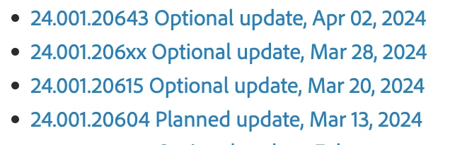

    Earlier i didnt pay attention, now I was trying to compare this version number with the released versions we have available, and I can’t match this number here: https://www.adobe.com/devnet-docs/acrobatetk/tools/ReleaseNotesDC/index.html
    These are the only versions that we released. I am also trying to confirm the version you have listed. And why are you using the old version?
    ~Tariq

    Quick clarification on the version question: 24.001.30365 is from the Acrobat Classic track, not the Continuous track. The release notes you linked (/index.html) lead to the Continuous track installer list — Classic track versions don't appear there because Classic has its own separate release notes.
    The relevant Classic release notes page is: https://www.adobe.com/devnet-docs/acrobatetk/tools/ReleaseNotesDC/acrobatclassic/acrobatclassic24.001mar2026qfe2.html
    This documents the March 2026 QFE2 release as version 24.001.30365. The Classic track deliberately keeps the major version at 24.001 because customers on perpetual Classic licenses (typically regulated industries) do not want auto-rollover to new major versions — they receive security and stability QFEs only.
    Additional confirmation that this is a current release, not an old one: the Last-Modified header on the working sibling file (also from build 2400130365) returned by Adobe's CDN is Tue, 14 Apr 2026 09:25:10 GMT — see the curl output in our previous email. So Adobe's own CDN confirms this is a 2026 file.
    To be clear on the question of "why are you using the old version": we are not selecting a version. AUSST synchronises whatever release the Adobe CDN manifest advertises as current at the time of sync. AcroAUSST itself fetches the manifest from Adobe and processes whatever files it lists. When we run AUSST against current Adobe endpoints, 24.001.30365 is in the manifest — that's how we know it's the version Adobe is currently advertising to AUSST customers.
