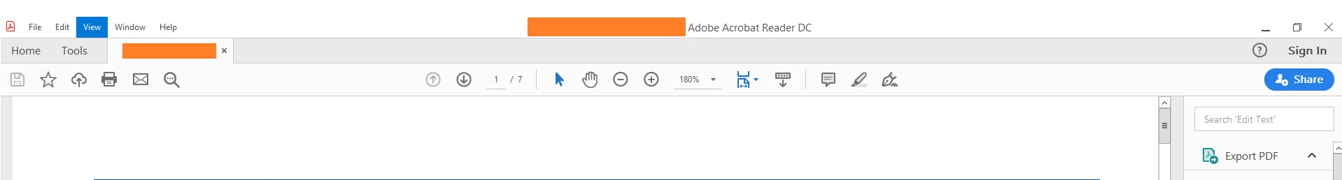

Blank bar along top of window
Following the update to Adobe Acrobat DC (19.021.20047) on our Windows 2012 R2 platform that there is a space along the top of the window  only when maximised (the space disappears when window is restored down).
This is causing an issue whereby when a user tries to move the mouse over the Menu bar, or tries to close, minimise, restore down the window, it actually clicks whatever is below the option.  Please see my screenshot attached, although the mouse pointer is not showing, the pointer was hovering above the "View" option as if it was over the View option.  Another example is if I try to click on the X to close the file it actually clicks sign in.  It's like the mouse pointers position isn't true to what it is selecting in Adobe DC.  The issue doesn't exist in any other applications on the server.

    Oct 16, 2019 3:06 PM UTC
    Thank you for your quick response, Anand.
    I have tried repairing the installation and that made no difference.
    Also, I do have two monitors, but switched to using one monitor and the issue remained.
    I tried changing the resolution and it made no difference.
    I have just realised, and it may be worth mentioning, that this issue is only happening when connecting to the terminal server through the Remote Application connection.  When I connect to the same server through a Remote Desktop connection the window displays fine.
