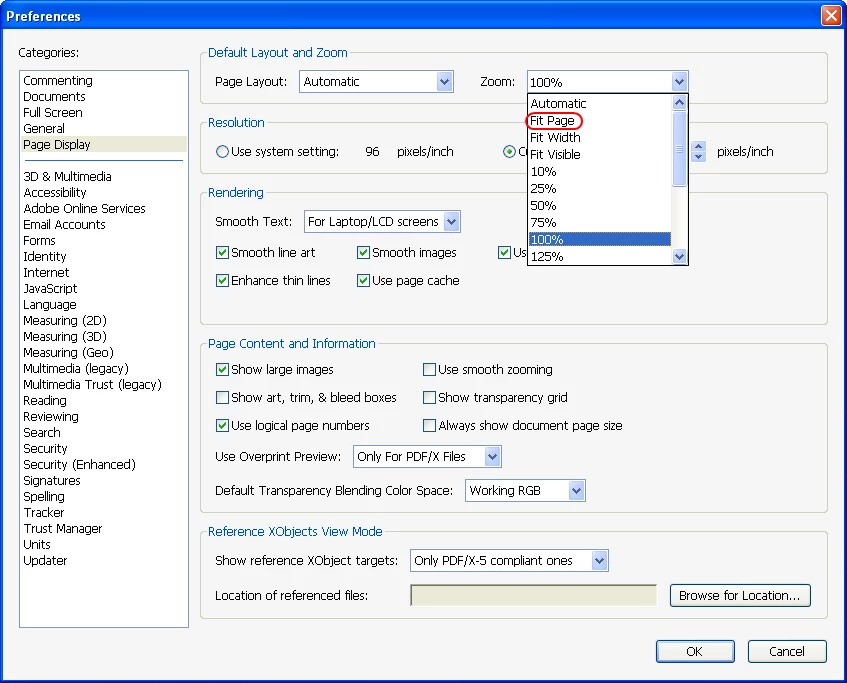

Does that also happen if you set the Zoom Preferences to 'Fit Page'?
Nov 7, 2014 5:11 AM UTC
Pat,
Yes, it does.  That setting tells Acrobat what zoom level to use by default when you first bring up the file.  I actually have the Fit Page setting in my preferences just like you show.  But once you hit the bookmark, the zoom level changes to whatever the PDF was created with for that bookmark.
