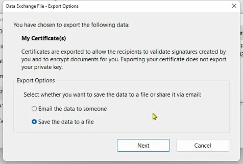

Do I have to extract the public key from my digital ID and send it separately to the receiver?

"Do I have to extract the public key from my digital ID and send it separately to the receiver?"
Yes. When you export the public key you will get 2 options:
