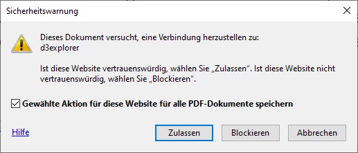

we have many pdf files, where we added a custom Link to our dms. The link looks like: "d3://d3explorer/idlist=GP01967690". In Word and other applications like different browsers, we can open this links. Only in Adobe Acrobat Reader DC we can't open this links. At the first click on the link, we get a security warning. Then we press "accept" and the "website" is listed in the known and accepted websites. But we can still not open the custom link.

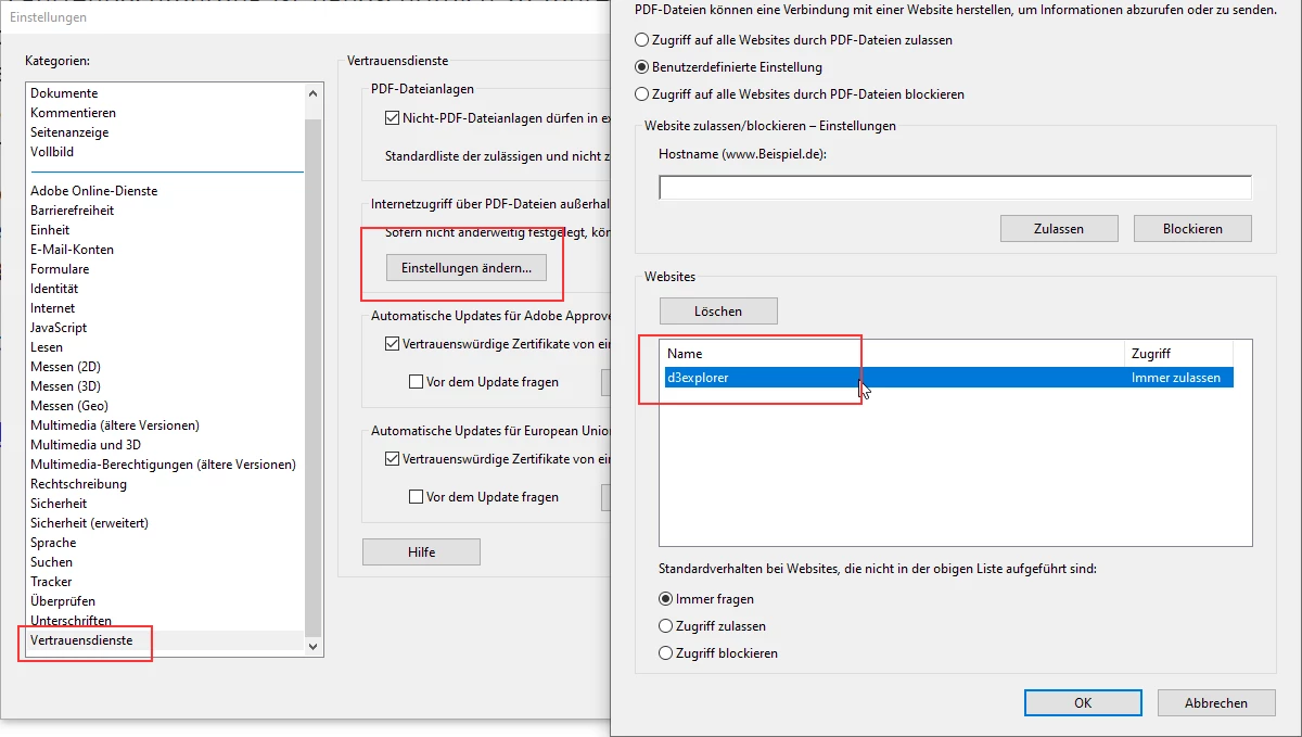

Since this is not a "normal" domain you will need to white-list it for the link to work. I can't find exactly how to do that right now, but it will most certainly involve a registry edit. Can you do that on all of the computers that are going to be using this file?
try67
Jan 4, 2022 11:00 PM UTC
Actually, you might be able to do it by adding it under Edit - Preferences - Trust Manager. Worth a try...

we used the Adobe Acrobat Reader DC Version: 21.007.20091 version. With this version we can't open the links. I already checked for updates, at the time, I faced this issue. Restart of the computer and so one, I tried too.
