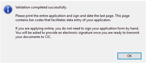

As you are filling the form online, once you complete all the highlighted field click on Validate tab.
Once the form validation is completed, you will get the pop-up window as shown below:
It is mentioned there " You will be asked to provide electronic signature once you are ready to transmit your documents to CIC."
Check if that helps.
For more information regarding the form, I would suggest you to get help from there Help centre.
