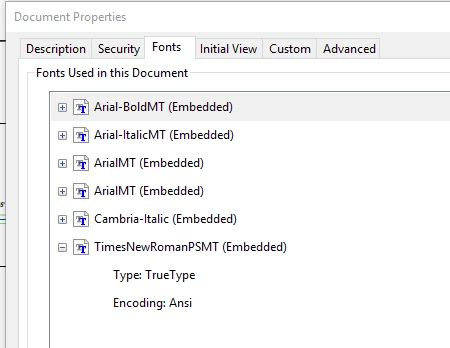

Jun 4, 2019 7:29 PM UTC
We are having the same issue running AutoCAD 2018 and Acrobat Pro.  We have tried unchecking "display in read mode by default", no luck.  Here are the font properties.  All fonts are embedded.

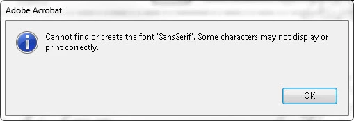

Jan 23, 2020 2:20 AM UTC
I am using AutoCAD 2019 along with Bluebeam and don't have this issue. Then one of our users had to use Acrobat and had the above issue with the Sans Serif font.
Since I can't control what software our clients are using to open the pdf's, I went looking for a solution. I tried this on Acrobat Standard 2017.011.30156 & Acrobat Reader DC 2019.021.20061 and recieved the same message. The only way I could fix this is to change the AutoCAD  plotter's pc3 file. I have found that if I change the Font Handling in the Custom Properties it worked. I chose to use the "Capture some" option so that the fonts that are pretty much standard windows fonts won't have to be captured.
This was the final result of all my testing.

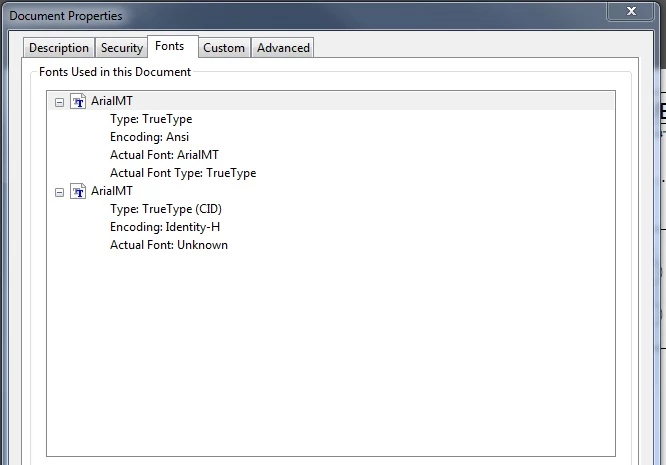

Dec 7, 2011 11:56 PM UTC
It sounds like the font information isn't being embedded properly. I know a lot of the MT fonts will not embed (a licensing issue with MS). Go to File>Properties>Fonts. Does it list ArialMT and does it say embedded or embedded subset next to it?
buhritoAuthor
Dec 8, 2011 12:12 AM UTC
Here is what I'm getting when I go to properties.
buhritoAuthor
Dec 8, 2011 12:16 AM UTC
ah ha, I just found the common denominator..
All the lines of text that won't display have a diameter ø symbol in them.
Apparently that doesn't want to cooperate?
