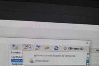

En el certificado instalado en octubre que funciona bien, NO aparece la opción "USAR PARA FIRMAR" en la pestaña del lapiz, cosa que con los otros certificados instalados meses atrás SI APARECE

El 21 de octubre de este mismo año instalé dos certificados digitales, antes y después del certificado del 13 de septiembre, y no me aparecen en la lista del selector de cerificados y tampoco hay la opción "Usar para firmar" ni la de "Usar para certificar" en "Certificate Details" en otros tantos ordenadores. Considero que es un problema de Adobe Reader, ya que puedo firmar los documentos con Autofirma sin ningún problema.

- Did you start receiving this error after the recent update or any recent change?: Yes, I have two certificates installed. One of them is from September 2022 and works correctly. However, the other certificate has been installed in October 2022 and doesn´t work to sign documents and doesn´t appear in the digital signature selector. This may be due to the latest update from Adobe.
- Try to create a new Digital ID and check if the same behavior occurs? Do the screen recording and share it with us: I can't record the screen, but I have tried manually installing the digital ID, importing it from a file on my computer. The adobe program detects it and allows you to add it. However, it still doesn´t appear in the digital signature selector to be able to sign documents.
