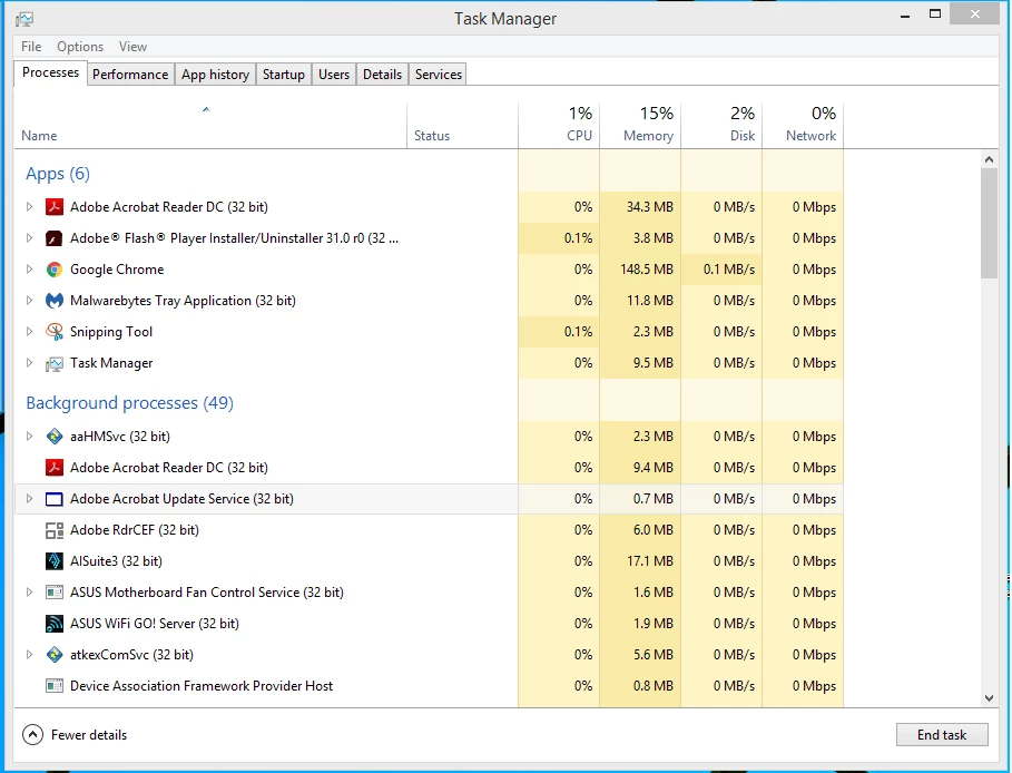

You can validate "my Adobe Updater Process" by looking at it's file path in the Task Manager, right mouse click on this file and check digital signature.

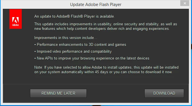

Here is "recently told me there is a new version available". This is the "Update Adobe Flash Player Pop-up" that pops up on screen as if it were an informing me of an automatic update. I do not run automatic updates and ask Adobe to inform me first. So this looks normal for Adobe.

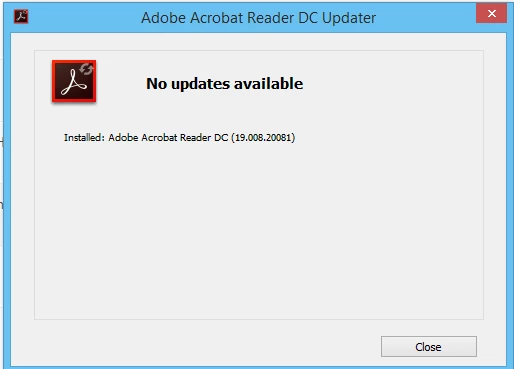

But when I go into my Adobe Reader DC (latest version) and go under help . . .
. . . . and select the command "Check for Updates". My adobe Reader DC tells me that there are . . .
Now if Adobe Flash Player needed to be updated then wouldn't the update show up here? Or is Adobe Flash player completely different because it is a different application?
Don't all Adobe products use the same updater service? I was under the impression they do?
Also, when I go into the task manager, I have this process called "Adobe Acrobat Update Service 32".
The process seems legit and runs under the path C:\Program Files (x86)\Common Files\Adobe\ARM\1.0
Digital signature seems correct.
I am guessing the Adobe Flash Player updater runs on a different update process or has a separate front end? It just seemed odd to me that I was getting a notification to update flash player and there was no update available when I checked it parallel under Adobe Reader DC >>>Help >>> Check for Updates. I gather these are two different balls of wax or tarballs or applications or processes or whatever right?
