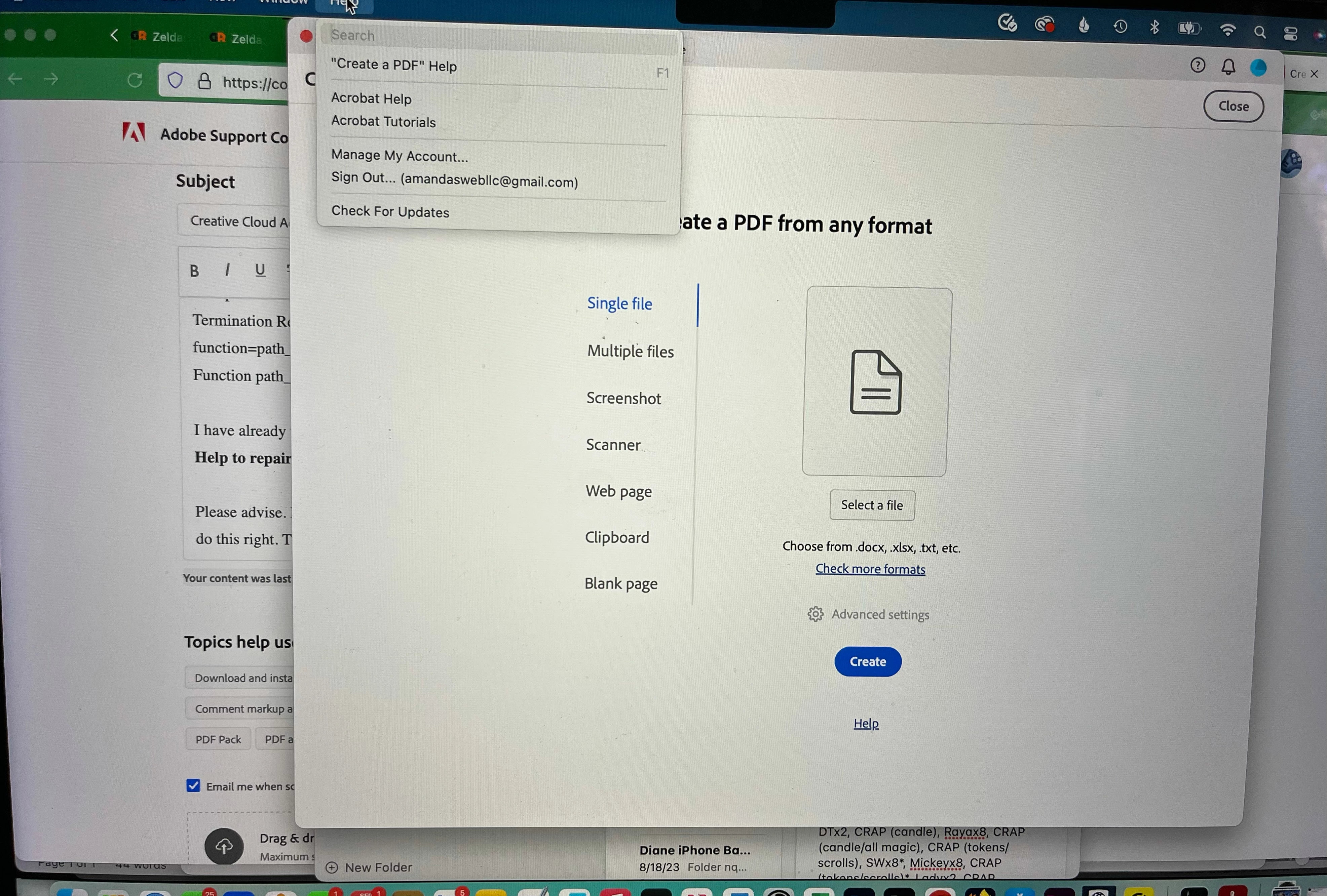

I have already tried uninstalling and reinstalling Acrobat, to no avail. There is literally no option under Help to repair my installation, so I can’t try that. See attached pic for proof.
