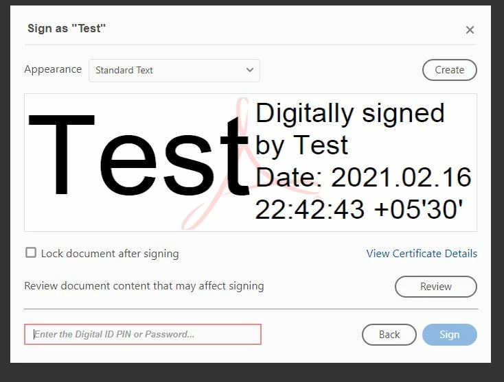

Digital certificate not displayed correctly
The digital certificate is not displaying correctly. The certificate is valid, and if you click on it, it's showing the correct information.
Could somebody help to get this sorted out? recreating the certificate does not help.
we see the issues below on multiple adobe reader installations

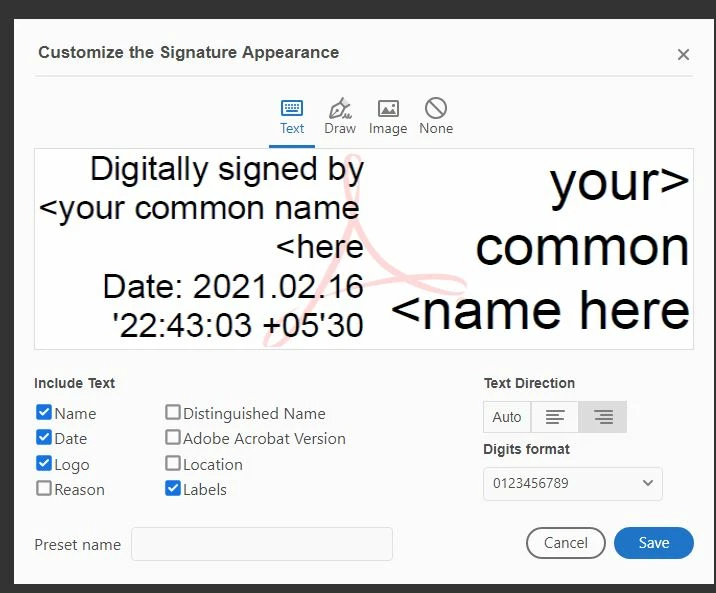

5. Can you please check if the issue is specific to L to R layout only
You can change the layout by choosing the option to create while signing and choosing Text Direction.

Ruud5C99Author
Mar 16, 2021 9:39 AM UTC
just test with the alignment, and with the Right aligment it works.
With the left or auto alignment it doesn't work
