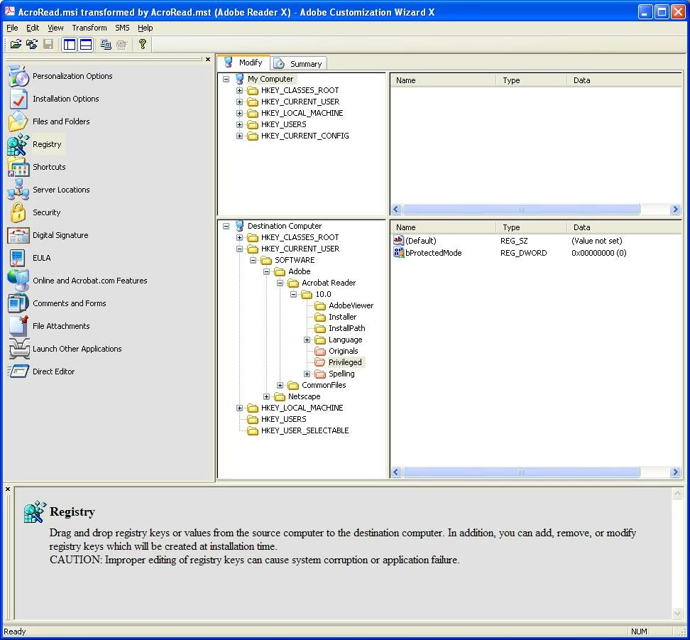

    wayne_OAuthor
    Jan 24, 2011 4:51 AM UTC
    Thanks Vinod,  I already have the setting for the Destination Computer in the Customization Wizard as shown in the image.  I then deploy using System Centre Configuration Manager and the setting does not come over. The others do.  SCCM uses the SYSTEM account to deploy.

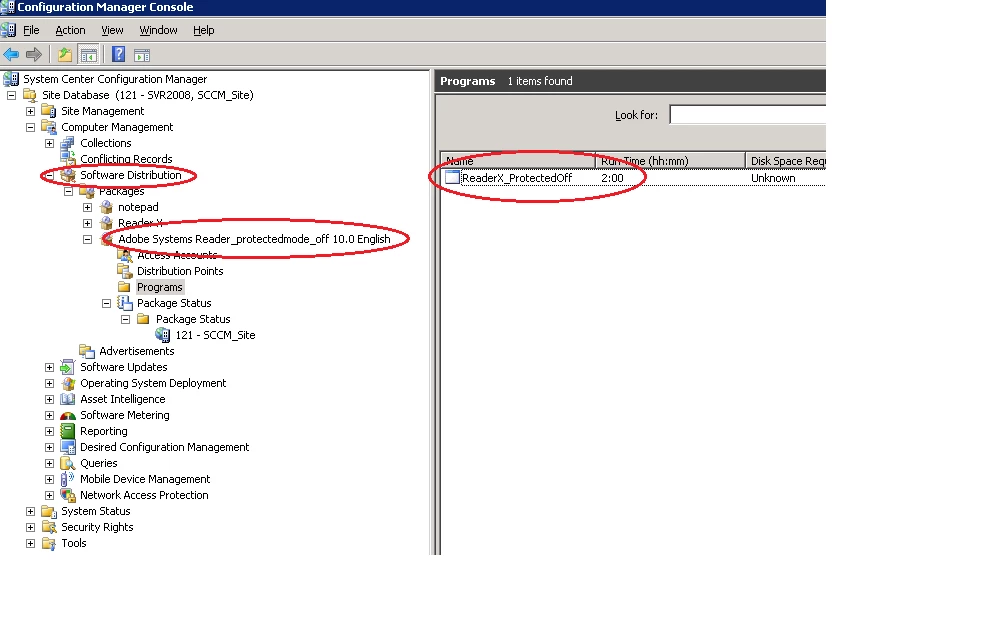

    Adobe Employee
    Feb 23, 2011 3:13 PM UTC
    Hi Wayne,
    I tried the same thing.
    1. Created the following customization using Adobe Customization Wizard X:
    [HKEY_CURRENT_USER\Software\Adobe\Acrobat Reader\10.0\Privileged]
    "bProtectedMode"=dword:00000000
    2. Deployed the modified build of Reader X using Software Distribution feature through SCCM.
    It created the following migrate keys in the registry:
    When I run Reader, the protected mode is turned off by default.
    Is this what you are doing? or can you list the exact steps with snapshots.
