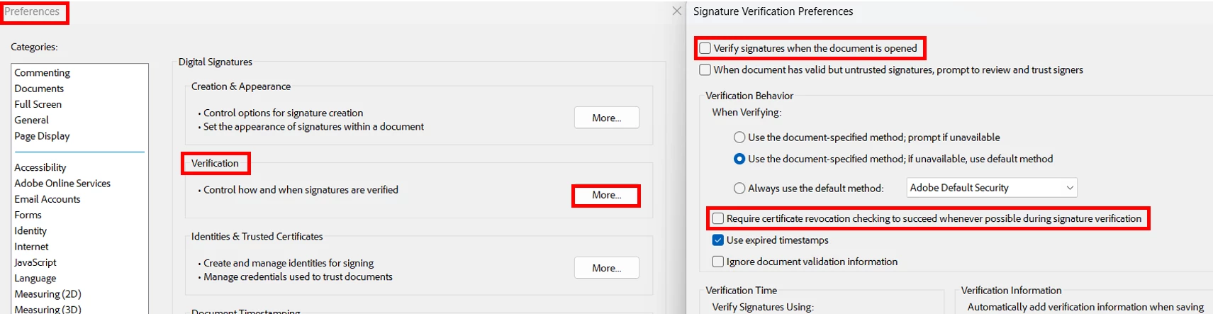

    I found this on one of the forums and it worked for me:
    Go into Preferences > Signatures > Verification and click More button > Uncheck "Verify signatures when document is opened" (top check box) and Uncheck "Require certificate revocation checking..." (middle check box) > OK

    Thank you- this tip saved me from a highly frustrating morning!
