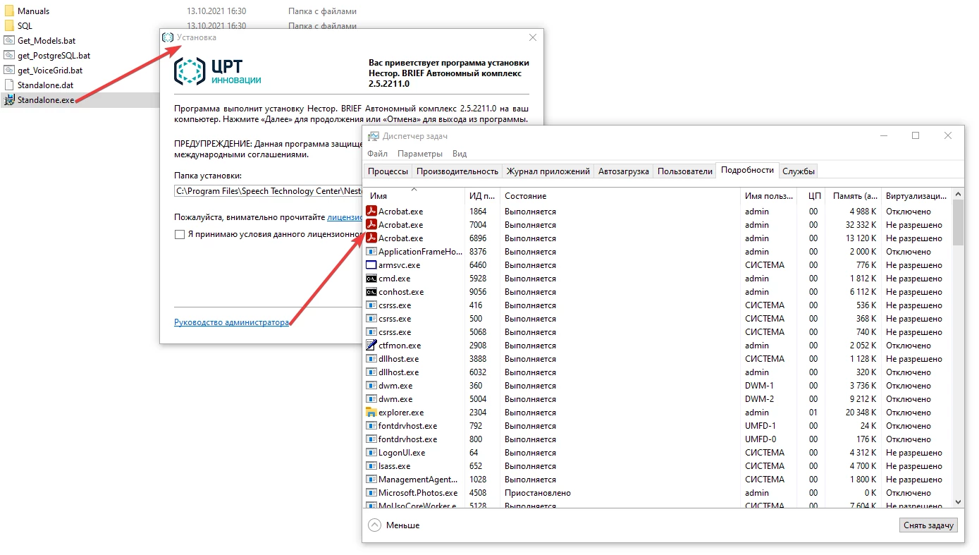

Freezed process Acrobat.exe when open pdf from installer
Hello!
We've got trouble with our pdf.
If we run our Admin_guide.pdf from our installer, the Acrobat.exe process has been freezer. As a result, our users cannot read the document.

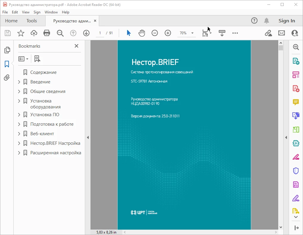

But if we open the document as a file from Explorer or in Google Chrome, it'll be opened successfully.

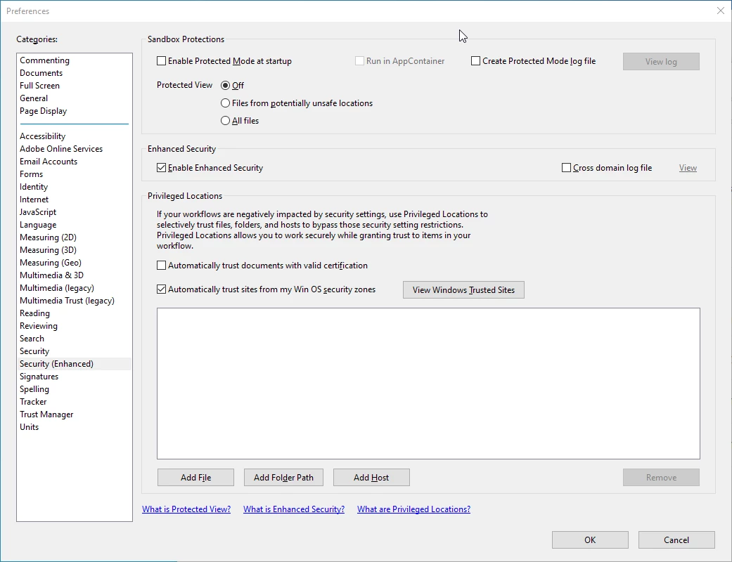

We use actual Acrobat Reader DC version (2021.007.20099) with default settings, but if we turn off Enable Protect mode, the document also opens from installer.
We think that recommending to disable Protect mode to our users is a bad idea.
The question is, what's the right method of solving this problem.
