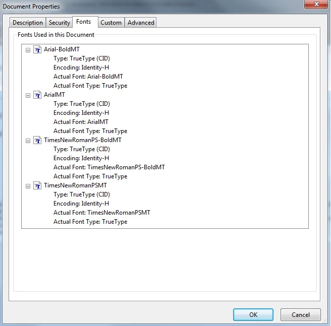

BeyondNAuthor
Jan 19, 2012 9:13 AM UTC
Sorry Ankit I can't upload the pdf but please find attached properties and pdf and fonts used.
I can open this PDF fine on another computer I tried copying all the fonts from that pc to the one where im having the problem and still shows funny
Thanks
nick
Jan 19, 2012 10:09 AM UTC
Please go to Edit > Preferences > International section and let me know the value of the "Slect Font" dropdown.
Also, check whether the option "Use Local Fonts" is checked or not under the Page Display section in the Prefereneces dialog.
