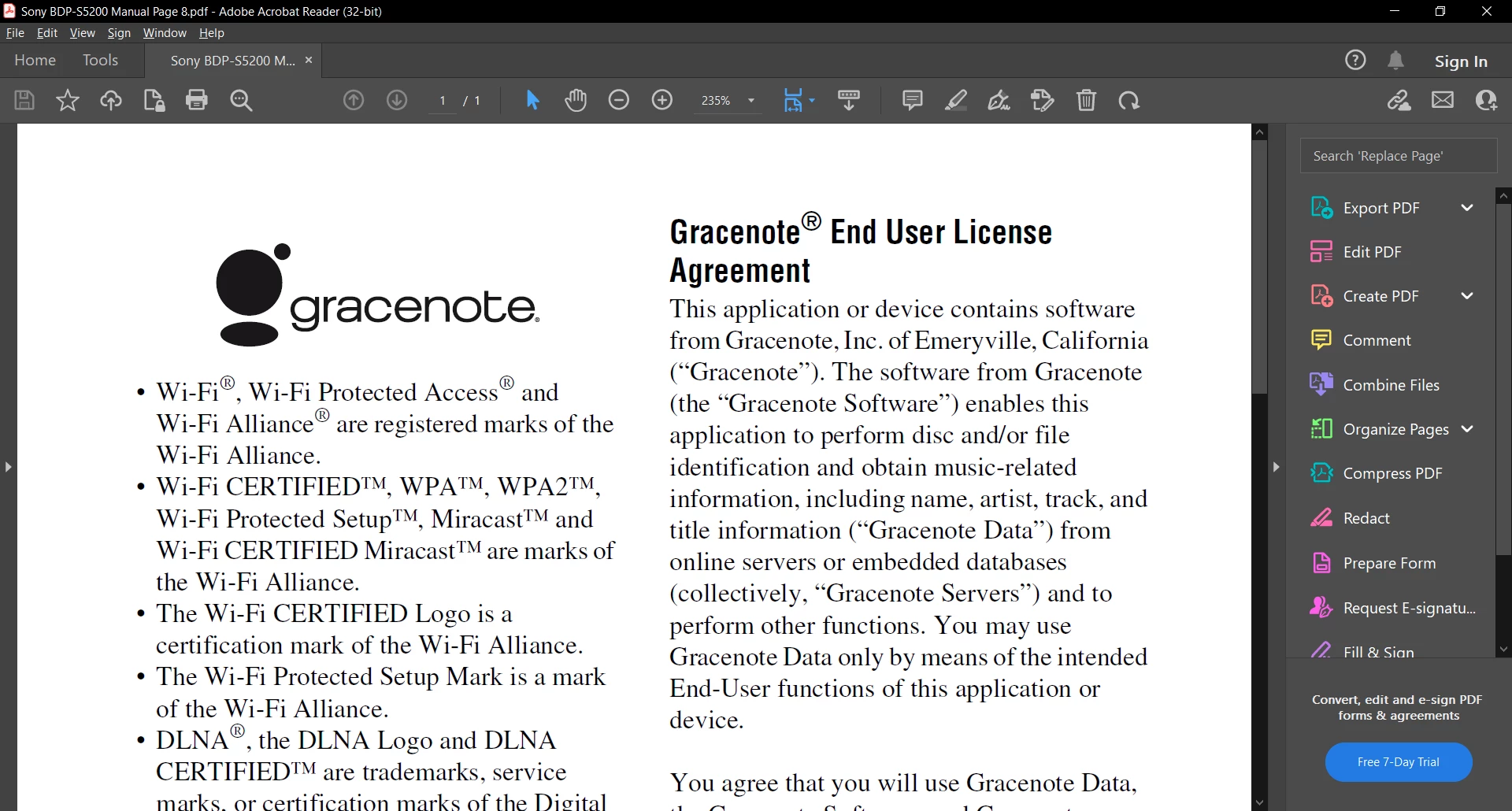

I then used the PDF24 Tools to split the 48 pages until I found that just one page, page 8, is the single page that crashes it. The attached PDF is that page 8.
Can anyone duplicate this and help determine what it is about this page that causes the crash?

Works fine for me:

Turns out this crash occurs on three different computers, and disabling Protected Mode at startup does not fix it. On a fourth computer it works fine.
The common factor on the three failing computers is that they all have the older Intel Core 2 Duo and Core 2 Quad processors.
The fourth computer that does not crash is a MS Surface Pro 2 with an Intel Core i5-4200U processor.
These of course are all old computers, but they are all running 64-bit Windows 10 just fine with no other issues with Acrobat or any other apps.
So it appears to me this crash is somehow hardware or driver related.
