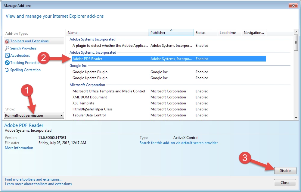

    September 11, 2015
    I solved it. See image below, but in text form:
    • Within Internet Explorer, navigate to "manage add-ons"
    • On the left-hand side, click the "show" drop-down box and select "run without permission"
    • Here, you will see an add-on called "Adobe PDF Reader". Select it, then click "disable".

    Adobe Employee
    October 17, 2012
    Please try the following steps to disable Adobe Reader browser plug-in in IE8:
    1. Launch IE8
    2. Click on Tools menu > Manage Add-ons
    3. Select "Toolbars and Extensions" under "Add-on Types"
    4. Select "Run without permission" from the drop-down menu under "Show"
    5. Select ""Adobe PDF Reader"
    6. Click on the "Disable" button
    7. Click on "Close" button to dismiss the "View and Manage your Internet Explorer add-ons" dialog
