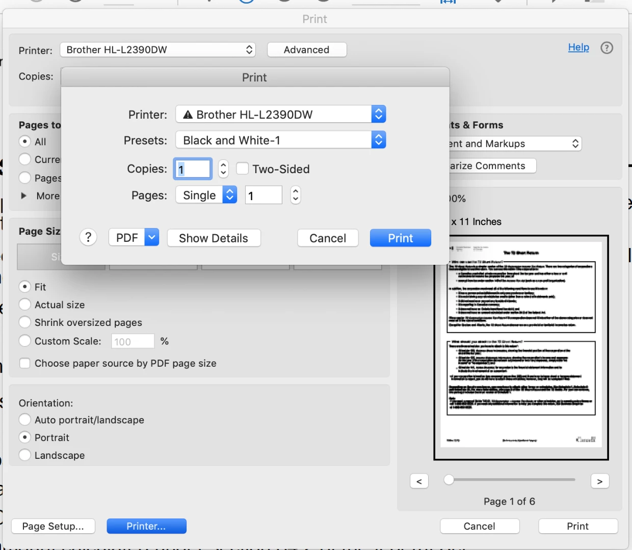

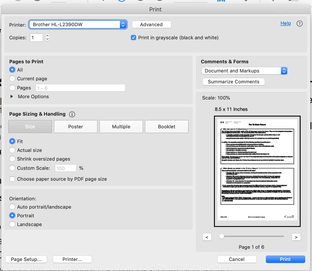

A solution to not being able to disable duplex printing of Adobe pdf files:  When you click "print....", this screen comes up:
If you click on "Printer.." on the lower left, this message comes up:
"The Print Setup dialog box is provided by the operating system. To ensure that you can use the full print capabilities of Acrobat Reader, please set all print options from the Application print dialog box. Do you want to continue?"
Click on the box in the lower left of the message window that says: "Do not show this message again".  Then Presto!, this screen comes up:
