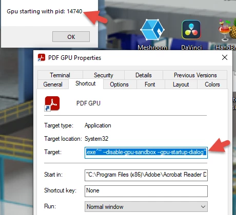

    This is good question. I had situation of PDF reader not being able to open heavy pdf file.
    You can create a PDF reader shortcut that force to use GPU.
    Once you use this shortcut it will open with GPU.
    See the example from my side (location may be different in your side).
    Target:
    C:\Windows\System32\cmd.exe /c "SET RENDERDOC_HOOK_EGL=0 && START "" ^"C:\Program Files (x86)\Adobe\Acrobat Reader DC\Reader\AcroRd32.exe^" --disable-gpu-sandbox --gpu-startup-dialog"
    Start In:
    "C:\Program Files (x86)\Adobe\Acrobat Reader DC\Reader"
    Feb 27, 2023 4:20 PM UTC
    Thank you.  When using the above shortcut for Acrobat DC, I get a dialog "There was an error opening this document.  This file cannot be found."  Any suggestions?
    Jan 22, 2024 3:24 AM UTC
    That's because this path he's provided, ("C:\Windows\System32\cmd.exe /c "SET RENDERDOC_HOOK_EGL=0 && START "" ^"C:\Program Files (x86)\Adobe\Acrobat Reader DC\Reader\AcroRd32.exe^" --disable-gpu-sandbox --gpu-startup-dialog") is no longer in Program Files (x86) but in Program Files.
