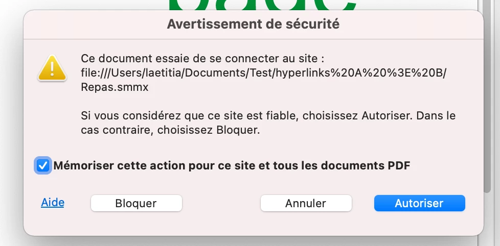

I have a pdf file that contains hyperlinks toward local files.
It keeps in opening it with internet instead of the right application (here a mind map application).
Would you know how to set it up correctly ?

To answer your question, even if the files are stored in a local drive or the location is on a local disk, the location is linked to a hyperlink with the PDF, which automatically triggers the web browser window to open.
This is designed behavior, and the same would be reciprocated if you also open the file on a web browser.

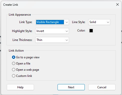

Hi @Laetitia285888887xzb,
The part mentioned "designed behavior" is for a specific type of linking done on Acrobat.
You may refer to the screenshot for reference.
If you use the option to open a file, clicking the link will automatically redirect you to the file. Depending on the file's content, you will also choose whether you want to open the file on the same window or a different window.
This depends on how the document is created.
You may learn more from Links and attachments in PDFs, and Adobe Acrobat.
