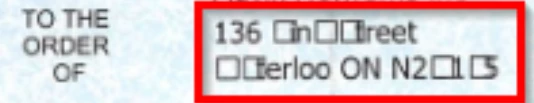

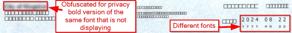

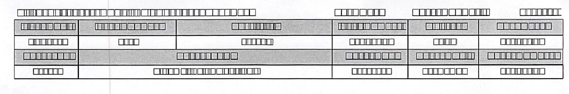

Every now and then a couple of files are printed with font character-sized rectangles in place of the letters. Sometimes some of the letters print, sometimes none of them. It seems to stick to specific fonts in a document at a time but it happens to both embedded and non-embedded fonts.
The PDFs do not contain the black rectangles when opened.

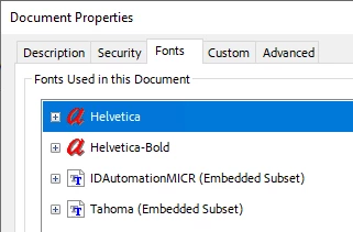

The ones in the example below in the first two images are supposed to be Arial which is installed on the server (Not sure why it displays as Helvetica which is not installed?)
I'm having a hard time finding any consistencies or patterns.
Sometimes some of the characters print but not all of them.
Sometimes the font that is supposed to print doesn't look like it's being printed alongside the rectangles.
This is supposed to be Tahoma.
Example document property fonts.
There are multiple examples of the Tahoma font not generating properly, so I don't think it's due to font embedding.
