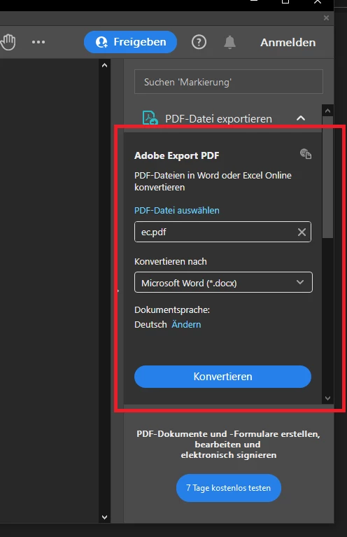

If you look at this attachement..
It seems that the first process is a relative long time busy while loading the red framed content.
