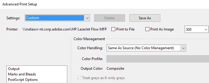

Could you also try printing the document as Image to see if that helps.
Print > Advanced> Check Print as Image
and also, are you experiencing this problem with all the files or with a specific one?
Regards.
Akanchha
December 6, 2016
Did as you instructed - exactly the same error messages.   Occurs on multiple files.
Of possible interest, the Print Advanced window you have pasted in above is not the same as the one I get on the Mac.  The window is Advanced Print Setup and has Postscript and Color Options only, as well as the Image check box you mentioned.
