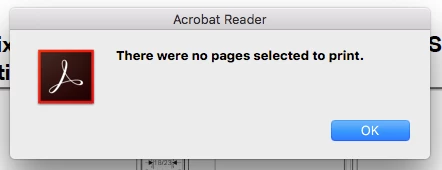

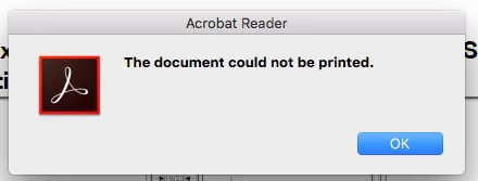

Mac: The document could not be printed. There were no pages selected to print.
  • September 20, 2018
  • 41 replies
  • 23200 views
I'm using the latest Adobe Acrobat Reader DC, with the latest version of the driver for the printer and I'm facing the same problem.
I did confirm that creating a new user with administrator privileges and trying to print from it didn't solve the problem.
Please help!
- Peter

    November 3, 2018
    Same issue here, but with older macOS:
    macOS 10.11.6
    Acrobat Pro DC version 2018.011.20040
    Hewlett-Packard CLJ 277 mv (USB-connected)
    latest driver
    same error messages that petraki-boy got (see screenshots above)
    This is an extremely unfortunate issue. It seems it has been around since March 2018, at least 2018 and is basically still unsolved for some combinations of macOS and Acrobat Pro. It means you may work in Acrobat, but have to print all .pdf from Preview.
    A short-term generally applicable fix would be highly appreciated.

    AnandSri
    September 20, 2018
    Hello Petraki_boy,
    We're sorry for the trouble you had with Adobe Reader, what is the dot version of Adobe Reader installed? To identify refer to Identify the product and its version for Acrobat and Reader DC
    What is the make and model of the printer installed?
    Is it possible to post a screenshot of the error you are getting? https://forums.adobe.com/docs/DOC-7043#jive_content_id_How_do_I_attach_a_screenshot
    What is the version of the operating system installed?
    We're here to help, just need more info.
    Anand Sri.
    September 21, 2018
    Hello Anand,
    Adobe Acrobat Reader DC version is 2018.011.20063
    The printer is a network connected Xerox WorkCentre 7835, driver version 4.17.1
    Mac OS version is macOS High Sierra 10.13.6 (17G65)
    Cheers,
    Peter
