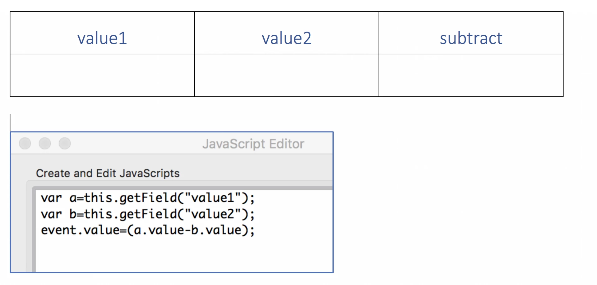

In this example, you can see the two field names in the table. This code would go in the field for subtract in the Custom Calculation Script. First the variables are defined, then comes the math.

I just kept reading though, and you want the "2" to be a variable. So that's in another field: FieldB and hidden Field A calculates Field2 + FieldB.
Am I following correctly?
Anyway, use hidden field for the intermediate calculations and come back if it doesn't work (and let us know if it does!)
You could also write JavaScript and do it that way.
