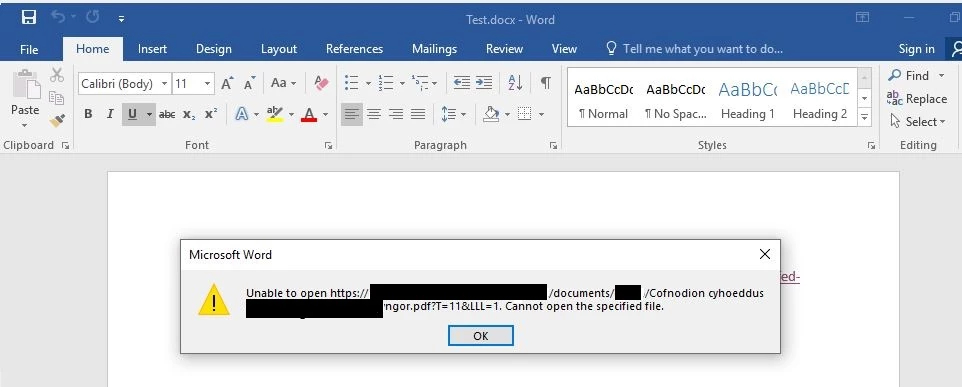

I am unable to open hyperlinks from within office documents to PDF files located on certain websites. The error I get within "Microsoft Office" program is :-
"Unable to open https://xxxxxxx.xxxxxxxxx.xxx/docs/pl456/CofiaCauyDrws%20Mae%20hi%20noer.pdf?T=11&LLL=1. Cannot open specified file.
I am able to visit the hyperlink in a browser and the PDF then Opens in Adobe Reder DC.

I have notice the exact same issue, and have just spent several hours on the phone with microsoft in an attempt to find the problem. In the end microsoft could do nothing and stated that this appeared to be a Adobe Reader issue as when the software was removed everything worked well. When the software was reinstalled this broke the links again.
Have tried this with several versions of Office and also Several versions of Reader DC. When DC is removed everything works.  I have tried getting support from Adobe on this issue but just get that there is no support for this application.
