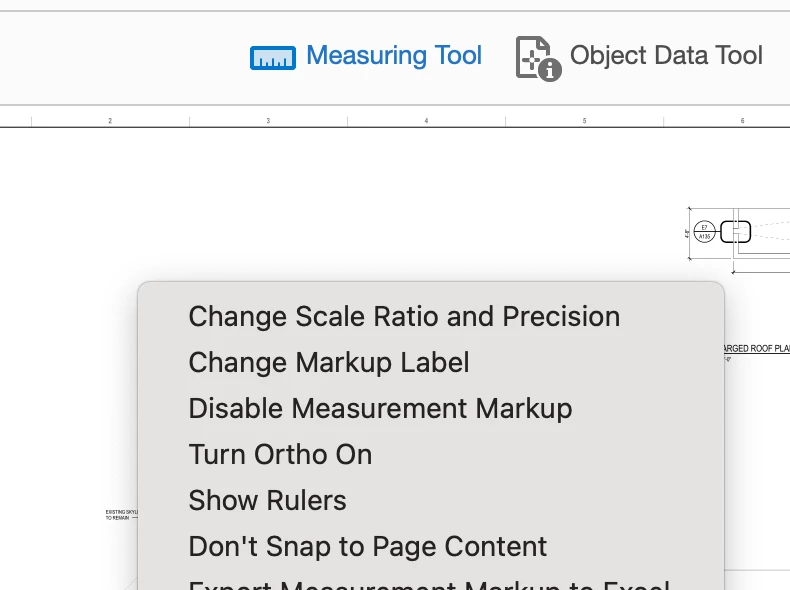

In the past, when I have wanted to change the scale ratio in Acrobat Reader, I would select the measuring tool and then right-click on my document to get a menu from which I would select "change scale ratio."
Starting this week, the "change scale ratio" option disappeared from the right-click menu. Screenshot below of the menu I get when I right-click.
Is anyone else running into this problem? MacOS Sonoma 14.4.1, Acrobat Reader v2024.002.20736.
Correct answer dylan_6790
turn off "Use Scale and Units from Document (when present) under Preferences - Measuring (2D)
Worked for me

Under file you have a end new adobe acrobat experience which takes you back to the old version, which works
May 15, 2024
@Andrew37285438ffmi and my fellow MacOS users, I found "Disable New Acrobat" under the "View" menu, and now I can measure objects again!  Hallelujah!

I've had the same problem. It's related to the latest version. Go to File and choose Change to Previous Version (or words to that effect). Do not agree to any future updates.

@David373280485i38 can you share a screenshot? Not seeing anything like changing to a previous version in the file menu. See below.
May 13, 2024
I'm having the same problem, and running the same OS and same verions of Adobe Acrobat as the OP (Andrew37285438ffmi).  I also do not see "Change to Previous Version" under the File menu.  @David373280485i38 or @Brian37295717y4zh, if you're using MacOS, can you please show us where to find this option?

Try disabling the new (and very buggy) Acrobat UI, via the Options button on the top left corner.

Another option: Create a measurement, then right-click it and see if this option appears in the pop-up menu.
May 11, 2024
Did you create a measurement and right-click? Did that work for you?
