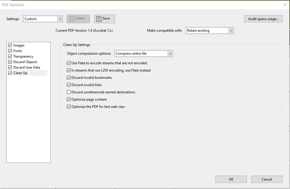

I had actually tried that on the original document and it didn't help the problem of the flattening message.  On other documents that might very well be the fix.
I went back and tried this again and under the pdf optimizer, clean up tab, there is no option to remove hidden layers content and flatten layers.
