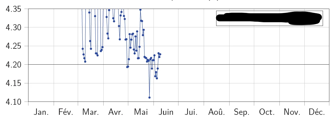

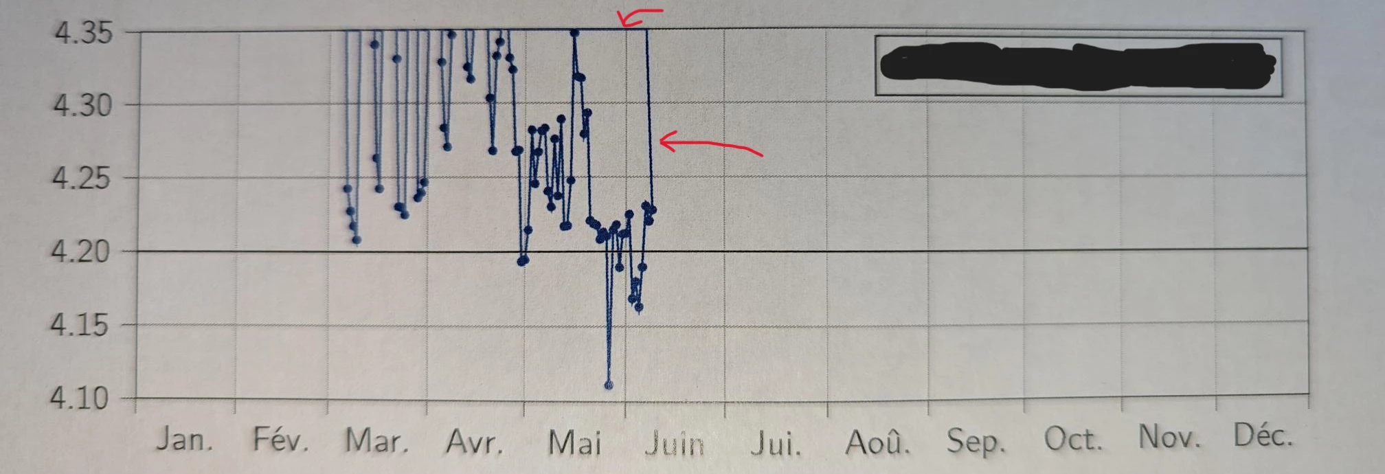

I have a problem when using Adobe Acrobat Reader DC for viewing and printing a pdf file generated with LaTeX. The difference is shown on pictures "pdf on screen.png" and "pdf printed.png" : a blue line is added to the graph...

Please find at least attached "main_test.pdf", which should renders differently on screen and printed, and the log file of the compilation of the document.

From what you say, it would indicate that the problem comes from my printer and its firmware...
Anyway:
  • I checked the version of Adobe Reader I'm using : it is 24.02.20933,
  • I tried the option "Print as image", and it works perfectly fine.
Definitelly, it tends to prove that the issue comes from the printer. It is a Ricoh IM C4500.
I will ask our IT department to check if the firmwares are up to date, and let you know if an update helps on the issue...
