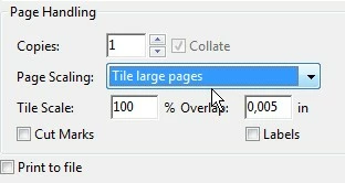

You are being very responsive but I still can not get the necessary option. In my Page Handling box the option is not shown. All I have is:-
Page Scaling > None / Fit to Printable Area / Shrink to Printable Area / Multiple pages per sheet / Booklet printing - and therefore no Tile Scale / Overlap / Cut Marks / Labels options.
My printer is an HP Photosmart C4380 but I do not think that this would be the cause as the options would be a function of the Adobe Reader Print Function I would guess.
Maybe there is a facility which I do not have switched on, or maybe there is a download I need. Do you have any further ideas?

Install Adobe Reader X.

In Adobe Reader X you can tile large pages in the print dialog.

Dec 5, 2011 4:10 PM UTC
In the print dialog of Adobe Reader X:
