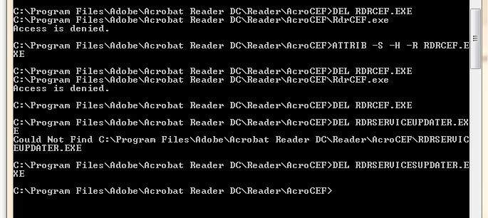

Nov 5, 2015 8:17 AM UTC
just delete the file acrocef.exe and rdrservicesupdater.exe from the folder C:\Program Files\Adobe\Acrobat Reader DC\Reader\AcroCEF
and you got rid of this annoying message like me.
close all adobe processes from task manager and after that delete it.
I used cmd.exe for it.
