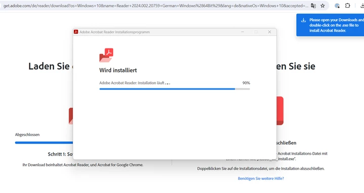

Reader's installation stuck at 90% and exits with an error
When trying to install Adobe Reader from https://get.adobe.com/reader/otherversions (Windows 11, Language German, 64 Bit distro), installtion gets stuck at 90%
and then exits with a generic error:

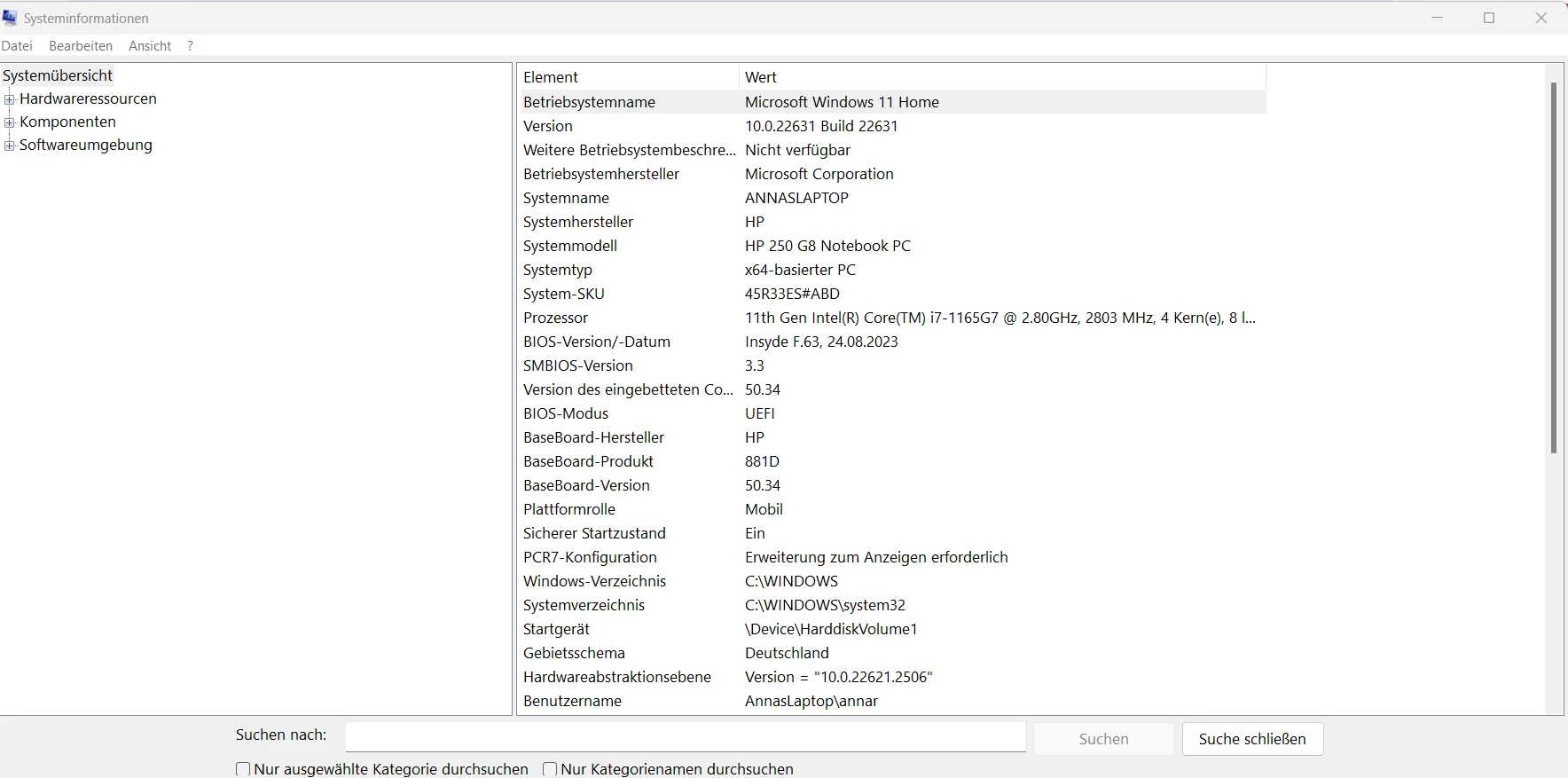

System Info:
