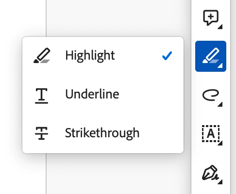

Hi...I'm sure I'm missing something really simple...however, I read earlier threads that said to "re-highlight" and hit delete...when I try to do that all it does is ADD another layer of the highlighting...so the highlighted text just gets darker/more opaque with each "re-highlight"/delete sequence.  I also tried looking in the "COMMENTS" for a "lists" of highlighted text to select a specific highlight and then hit delete, but could not find such a "list."
Is it just the PDF document I'm in, or is there something else I can try...had no trouble highlighting.  The only solution I have found is to close the document and hit "Don't save."  Then I am left with the original without any highlighting.

    After a lot of tries, here is the easiest way I found to delete highlighting from text:
    1. Right click on the highligting.  If you do not see "Delete" as one of the options, select "Properties".
    2. In the bottom left corner of the "Highlight Properties" popup UNCHECK the "Locked" checkbox.
    3. Then CHECK the "Make Properties Default" checkbox. Select "OK"
    Now right click on the highlighting.  You should now see "Delete" as one of the options.  Also, if you left click on the highlighting, you will see the Trashcan icon.  Clicking either Delete or the Trashcan should delete the highlighting. Left click also gives you a quick way to change the colors of your highlighting without having to open the Properties menu.
