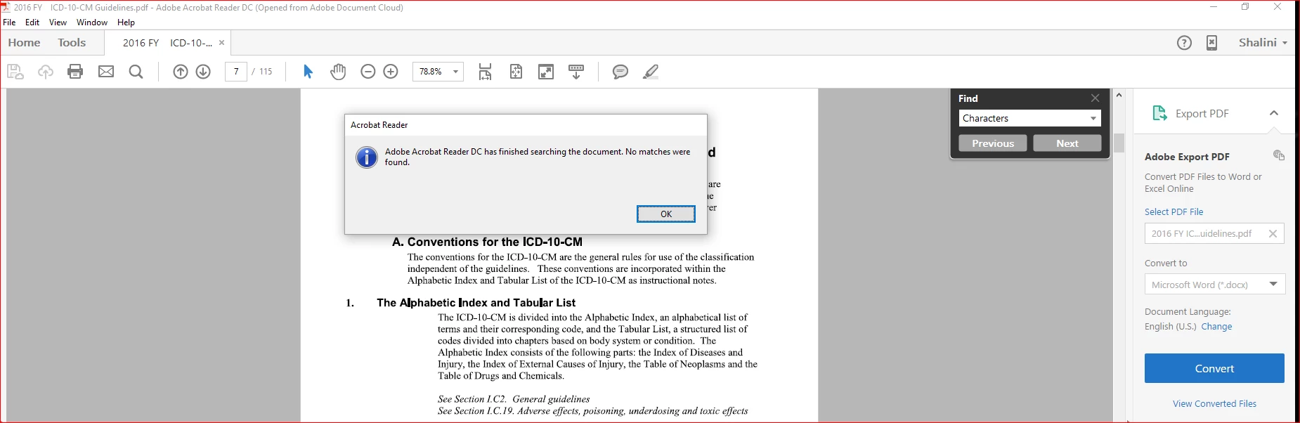

shalinis38966990
Jul 11, 2016 3:40 PM UTC
I still cannot search.
