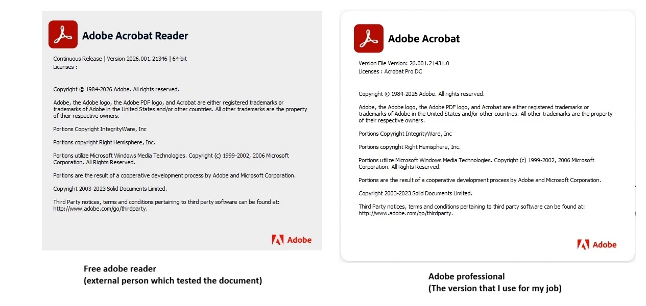

    - Versions used:
      For my work, I use Adobe Acrobat Professional.
      I asked someone with the free version to test the document.
    In both cases, see the screenshot for the versions

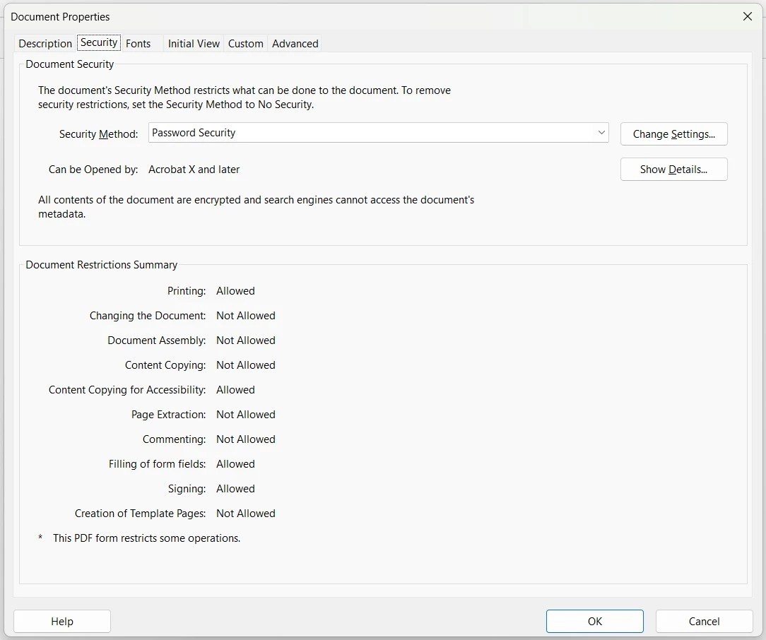

    - Security:
      Regarding security, yes, I protected the document with a password.
      See the screenshot.

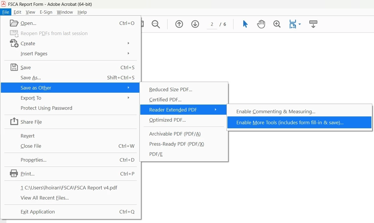

      You might say: it's possible to activate the backup with the command:
       Menu    : File
       Sub-Menu: Save as Other/Reader Extended PDF/Enable More Tools (...)

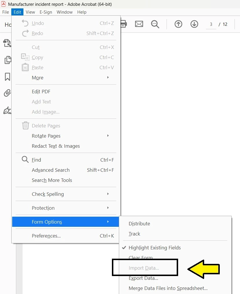

    I did it. At this point, this document no longer works with "Adobe Professional".
      The user can no longer import data. The command is not enabled.
      See screenshot.
      They can still perform other functions (export, print, and sign the document).

    When you use “Reader Extended PDF” (Enable More Tools), Adobe Acrobat Pro adds special usage rights so that users of Adobe Acrobat Reader (free version) can fill, save, sign, etc. However, once a PDF is Reader-extended certain advanced features (like Import Data) become restricted, even in Acrobat Pro. This is expected behavior by design, not a bug so you’re seeing a limitation of how Reader Extensions work.
    You cannot have both at the same time:
    • Allow free users (Reader) to save & sign AND
    • Keep advanced Pro features like Import Data active once extended, the document is “locked” into a mode optimized for Reader users.

    We need some more infomation to better understand the issue:
    • Which version of Acrobat are you using? Go to Help > About Acrobat and try updating the application to the latest version available. Go to Help > Check for updates and reboot the computer once.

      Go to:
      File > Save As Other > Reader Extended PDF > Enable More Tools (includes form fill-in & save)
