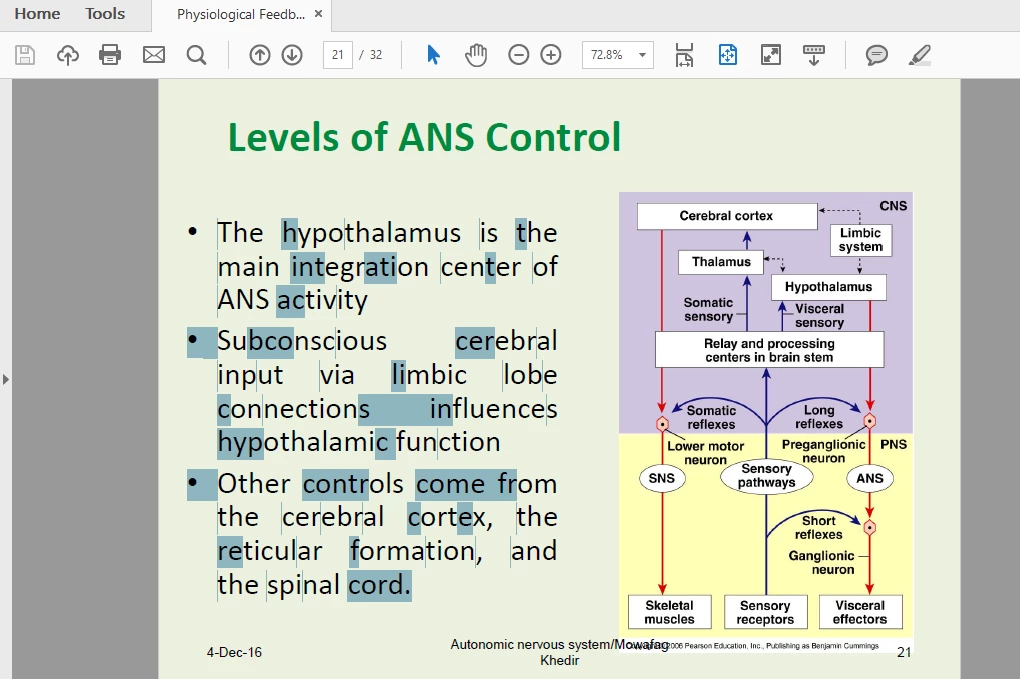

hello everyone.
some of my PDF files not allowing me to select text to highlight it, they contian real text not images or scanned- based, and when I go to the document properties the commenting section is allowed and there is no security on document.
other PDF files are fine, I can select text and highlight it.
this is what happen when I select text in some documents
it is irregular and  juming words. so irritating
please help
    Correct answer try67
    This happens when the file was created in a non-standard way, or is the result of a partially successful OCR process.
    Basically there's nothing you can do about it with the free Reader. Report this issue to the author of the file and ask for a new version.
    The only workaround you can use on this version is to use a different tool for the highlights (like the Square tool), or to hold down Ctrl before applying the highlight. That should switch it from text selection to free-form selection and you would be able to select an area to highlight, instead of just letters.

    What can you see when you save the file as text?
    December 23, 2016
    I'm sorry I didn't understand your question, but the file is powerpoint converted to PDF
    and I download it as PDF from my e-mail.
    Bernd Alheit
    December 23, 2016
    In Acrobat Reader you can save the PDF file as text.
