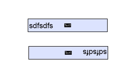

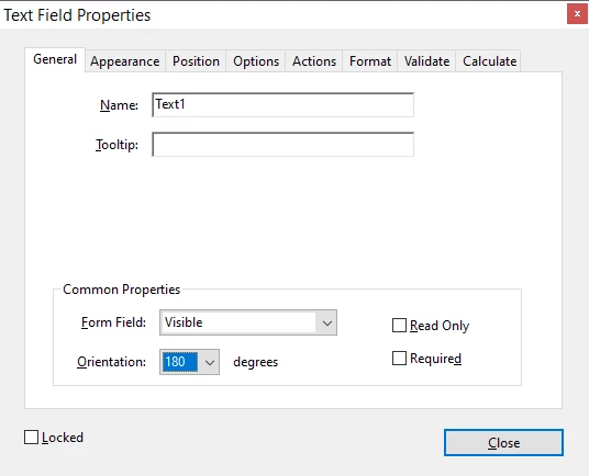

If so, you can give the fields the same name, and just change the Orientation setting of the upside-down ones to 180, via the field's Properties, like this:
That way you would only need to enter the text once (in either field) and it will appear correctly in both of them:
(Top field has the Orientation set to 0, bottom one to 180)
