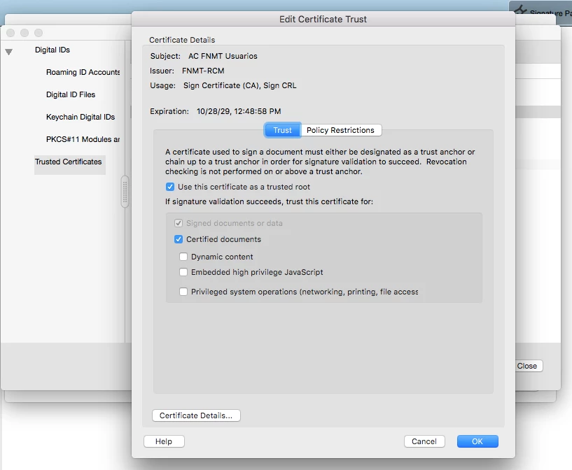

This "the credential selected for signing is invalid" message appears when you use a trusted certificate as a trusted root. Probably because Adobe finds something wrong in the trust chain.
Just by *disabling* the checkboxes below the message disappears and digitally signing works:
Enjoy it

I found it!
Enjoy it
March 23, 2022
Thank you so much, it worked!!!
Finally found the right answer
