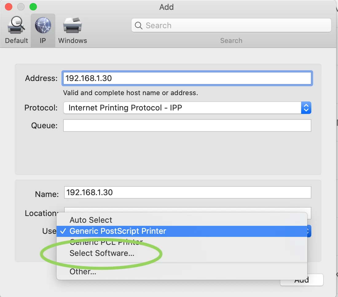

The 180 degree rotation trick fixed it for me (Mac OS10.15.7, Acrobat DC 2019.021.20048, Canon D1620 printer).  I also tested on Big Sur 11.0.1 and it works there as well.
One important note: I had to use the postscript (PS) version of the printer driver. The default multifunction driver DOES NOT work.  When you set up your printer (system preferences>printers & scanners), don't use theDefault/Bonjour setup. It won't work.  Instead, choose IP in the menu bar, enter your printer's IP address, then in the Use: pulldown at the bottom, choose "select software..." then choose your postscript driver.  Voila!
This dang problem had plagued me for 6 years. Problem Solved!  Thanks, besposito!!
