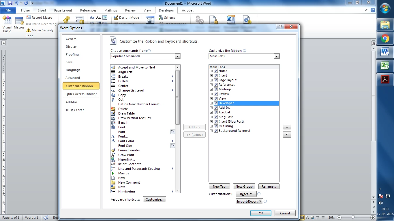

You can install the above VBA code by following these steps:
1. Select the Developer Tab in the Ribbon. If it is not shown please follow the instructions below.
     * Right click and customize the Ribbon and tick the Developer Radio button
2. Select “Macros” in the Developer Tab.
3. Give the name “GoToPDFPage”.
4. Click “Create” button
5. and the “Microsoft Visual Basic” window will open
6. You should write in this window the source code that is given above. At the end the window should look like the one below:
Then you can save and close this window.
7. Finally, you should see a macro named “GoToPDFPage in the “Macros” window.
Now every time you want to activate a hyperlink to a specific PDF page you should have the cursor inside the link text and then you should execute the GoToPDFPage macro either by clicking the “Run” button in Macros window or by assigning a keyboard shortcut to this macro following the steps below:

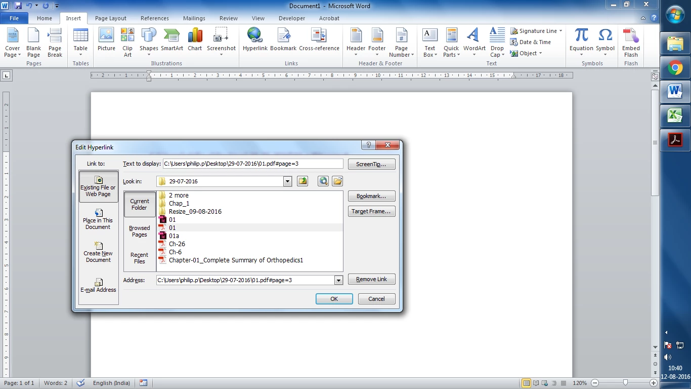

9. Now create your hyperlink, (Click on hyperlink and in the hyperlink dialog box select your desire pdf file and at end of the string type "#page=" see the image
When it has done keep your mouse pointer to the created hyperlink and press Alt+I (that we have created a macros shortcut key).
