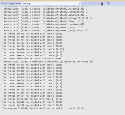

We have a plug-in application, which was implemented for 32 bit Acrobat was fine on the same.
Recently we got a requirement for 64 bit version of acrobat, so I followed the steps mentioned in 64 bit SDK and upgraded the same application for 64 bit acrobat.  I was able to compile the code and successfully created the plug-in, which I added to plug-ins folder of acrobat (say....  Adobe\Acrobat DC\Acrobat\plug_ins).  But when I try to open the acrobat, it is not opening the acrobat. (and when that plug-in removed from the folder, acrobat opening).
When I try to debug the code,  below things are shown.
What causing the acrobat failing to open in my Plug-in application.
Please help me to sort out this issue.

Sorry it really helped me (Adding a MessgeBox at different functions), to figure out the problem,
It is actually a dll in our code, that was preventing our plug-in application,  when I bypass that dll code, plug-in loaded into acrobat and acrobt menu showing my plug-in app.
thank you for your suggestion.

Maybe it would help if you could provide some idea as to what your plug-in /code does, based on the above it is doing something that is not liked and therefore erroring, but this is very hard to work out without actually seeing what you are running.
Can you cut down your plug-in, and if it loads, then gradually add more of it back in, until it fails?
