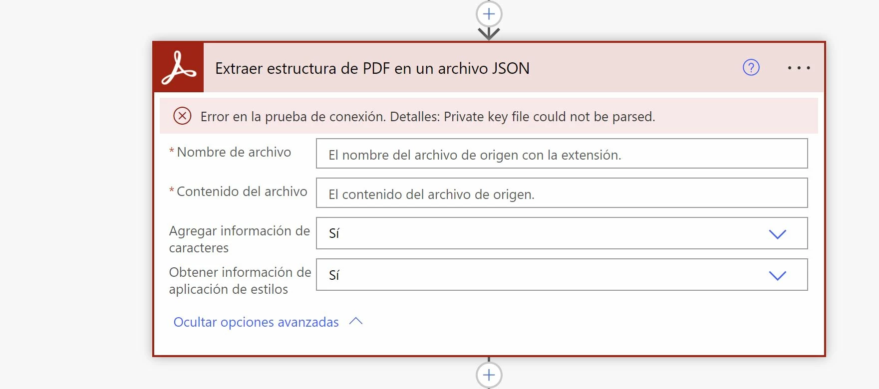

Autentication Problem with PDF Services in Power Automate
I have authentication issues using PDF Services with Power Automate, after succeeding the authentication and perform operation Create Searchable PDF using OCR without problems I tried to use the Extract PDF Structure in a JSON File. Unfortunately with that functionality I have an error of “Private key could not be parsed”, I do not understand because for other functionalities of PDF services works fine.

When you paste your private key in, don't remove any of the tags or anything. Take the entire item including -----BEGIN RSA PRIVATE KEY----- and -----END RSA PRIVATE KEY-----
